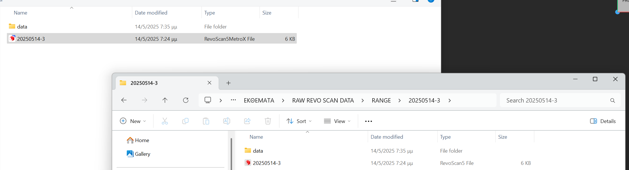

I know it seems impossible!
In the screenshot, the same file appears as MetroX type file when trying to import it in Revo5 and it correctly appears in folder browsing.

It seems like all projects use the non-MetroX icon on my computer. I’m not sure that means anything.
Take a look at the .revo file from a working project in Notepad. Compare it to the .revo file with the missing scan(s). I would bet the corrupted scans are missing from the “nodes” section so Revoscan doesn’t know it exists.
