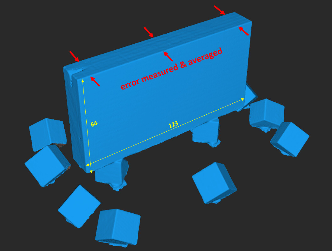

Then I did the following test using a plywood board 123 x 64 x 17.6 mm in size as the object. The steps and results are as follows :
  1. do a dummy scan for 30 min. Calibrate immediately. Scan immediately. Average error +0.06
  2. switch off the scanner for 30 min allowing it to completely cool down. Scan. Average error +0.13
  3. do a dummy scan for 30 min. Scan immediately ( NO re-calibration ). Average error +0.07
  4. Let it cool down. power it on for 30 min, NO scanning. Then scan. Average error +0.13.
  5. Let it cool down again, do a dummy scan for 30 min. Scan immediately. Average error +0.06
It appears that the scanner does need be warmed up to the temperature at which calibration is done to achieve maximum accuracy and effective warm up does require the scanner to be working, not just powered on.
