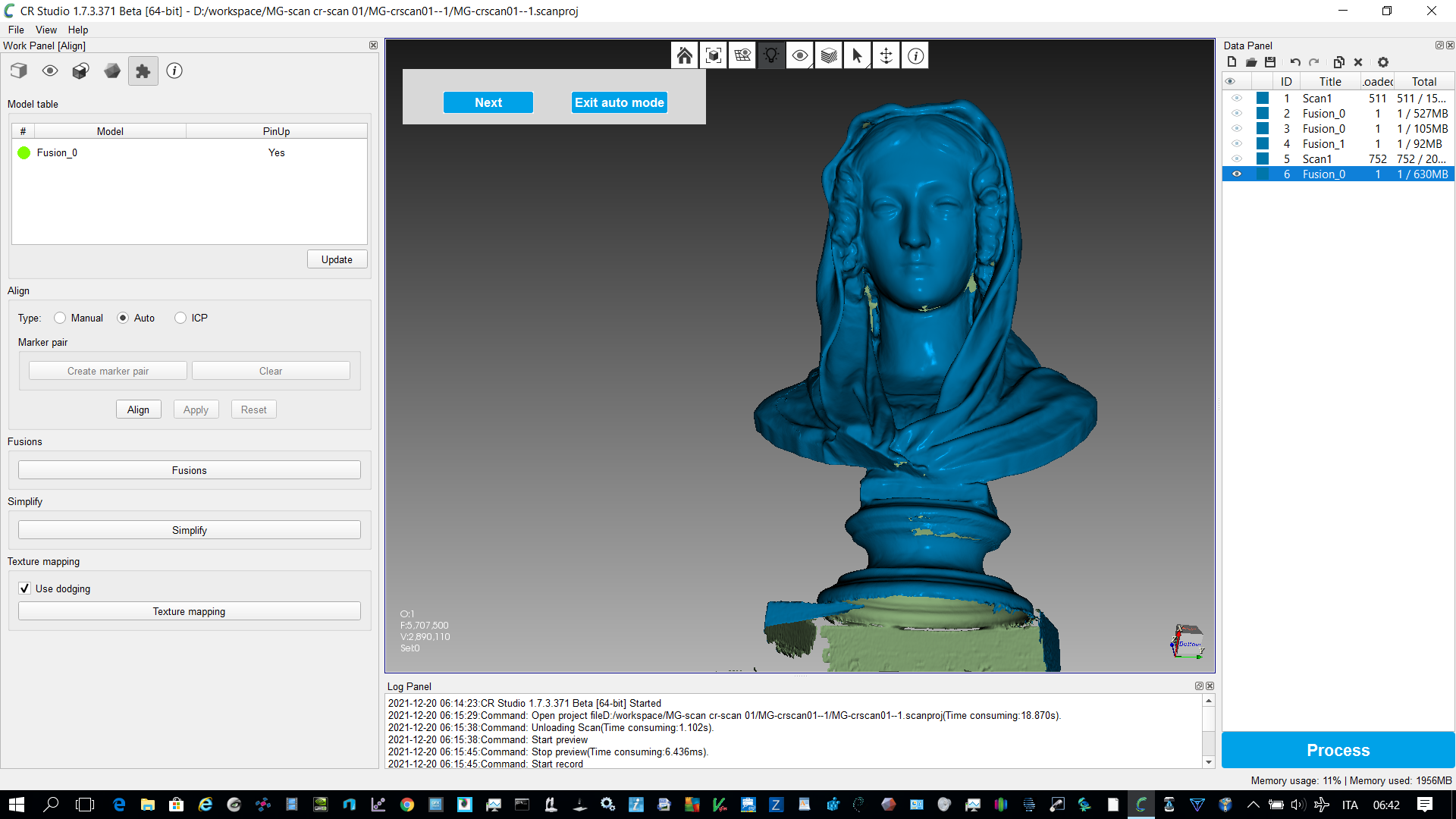

Finally, I add, for comparison, the scan of the same sculpture made with the Creality Cr Scan 01 scanner.
The 3D scanning was done, as in the case of POP 2, in two parts (at the maximum possible resolution).
In this case the alignment of the two parts was done within the Creality scanning software (CR Studio).
Meshlab was used for the creation of the mesh and for the editing operation.
Below is the final result.
As you can see, the model is clean and virtually free of artifacts.
On the other hand, there is a certain loss of detail. The surface is a bit “flat”.
Finally a side by side comparison
