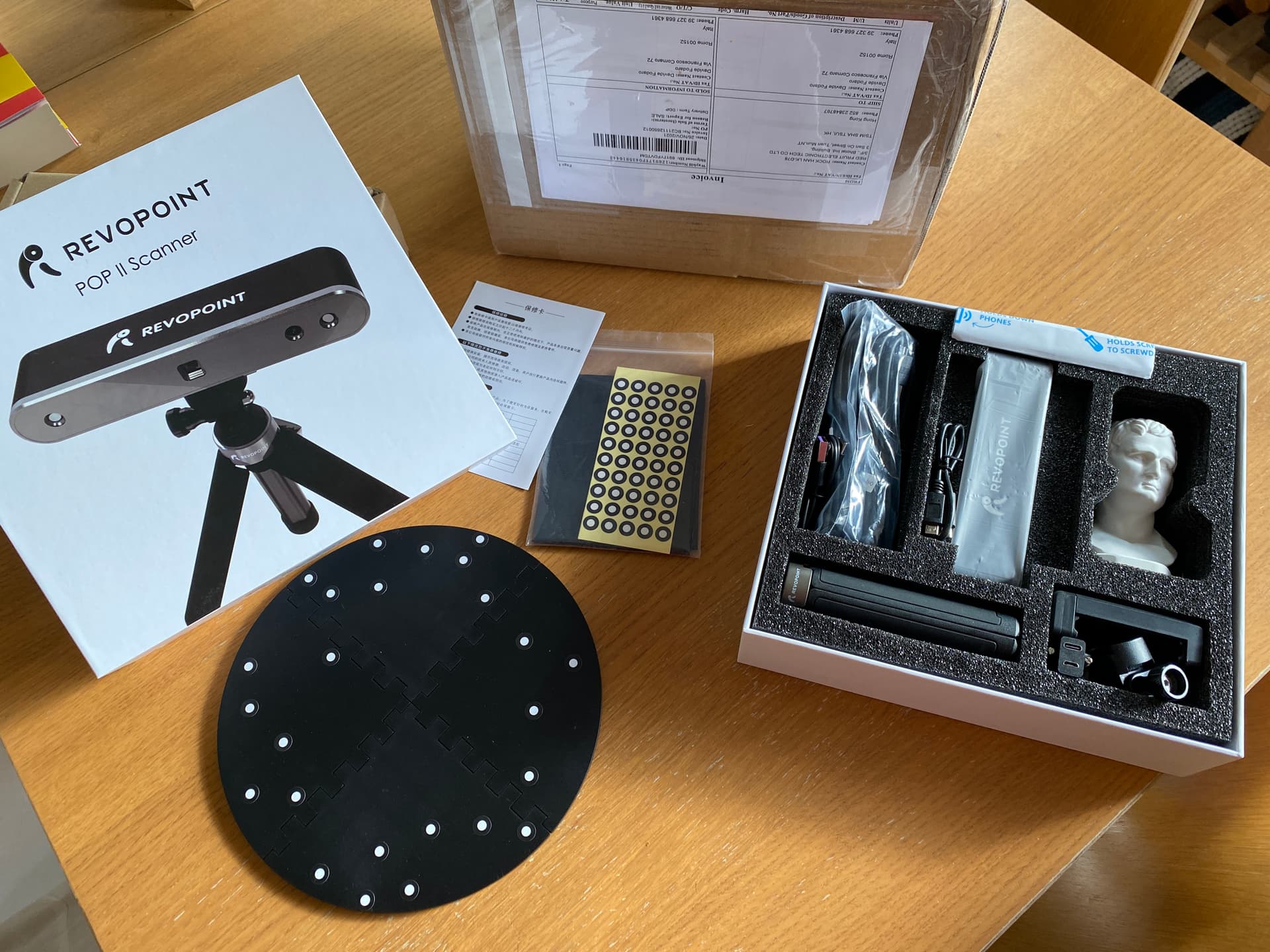

In the images you can see the contents of the package I received:
It is a complete set, with also the turntable.

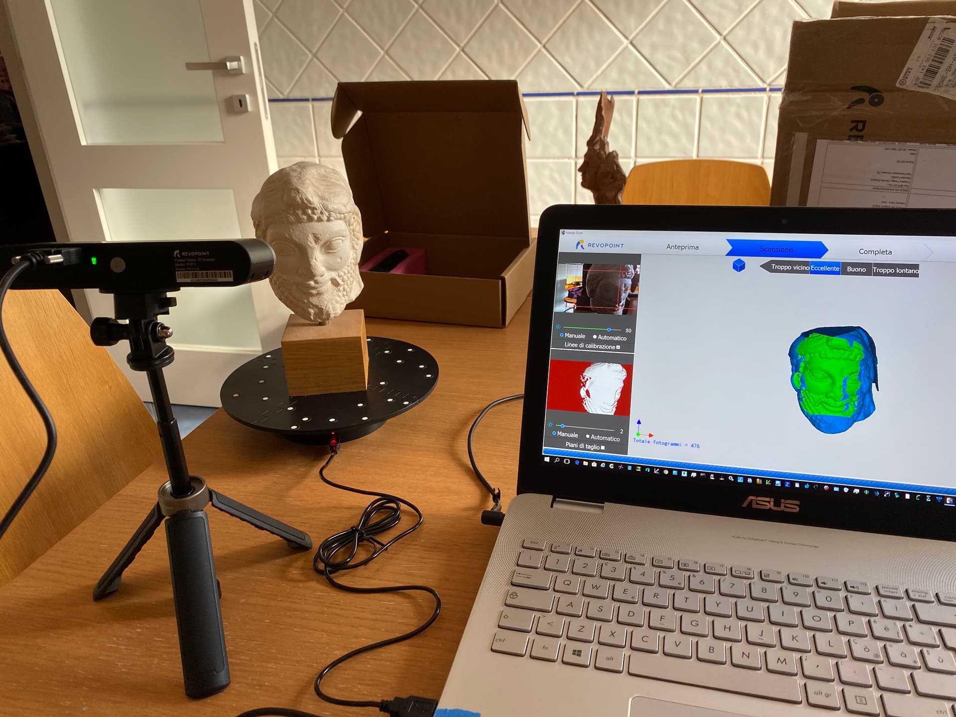

In the photo the set prepared for the scan of the sculpture:
I liked the build quality of the scanner (solid metal) and also the accessories:
Tripod with gopro type one-button quick installation
Turntable - can be used both with batteries (therefore no power cable) and with the USB cable, supplied, which can be used by connecting it to a USB port on the computer, or with a smartphone power supply, or with a powerbank
Phone holder
Photographich handle with powerbank
All connection cables for the scanner
In using the Handy Scan application, I appreciated the fluidity of the acquisition (the frame rate increased to 10fps is appreciated and also the enhanced built-in cpu -now dual core with NPU- present in the scanner that processes the acquired 3D data)
To be able to compare the quality of the scan with POP 2, I performed the acquisition of the sculpture using the turntable as in the previous test.
Also, I set the scan quality to maximum accuracy.
The scan was carried out by placing the sculpture vertically and the scanner mounted on the tripod at the distance that allowed me to scan in “Excellent” mode
After the first full rotation, I stopped the scan and raised the scanner (using the telescopic extension of the tripod), then I resumed the scan.
Lastly, I performed the merging of the points (in “high precision” mode it takes a little more time than “fast scan”) and then exported the “point cloud” in PLY format.

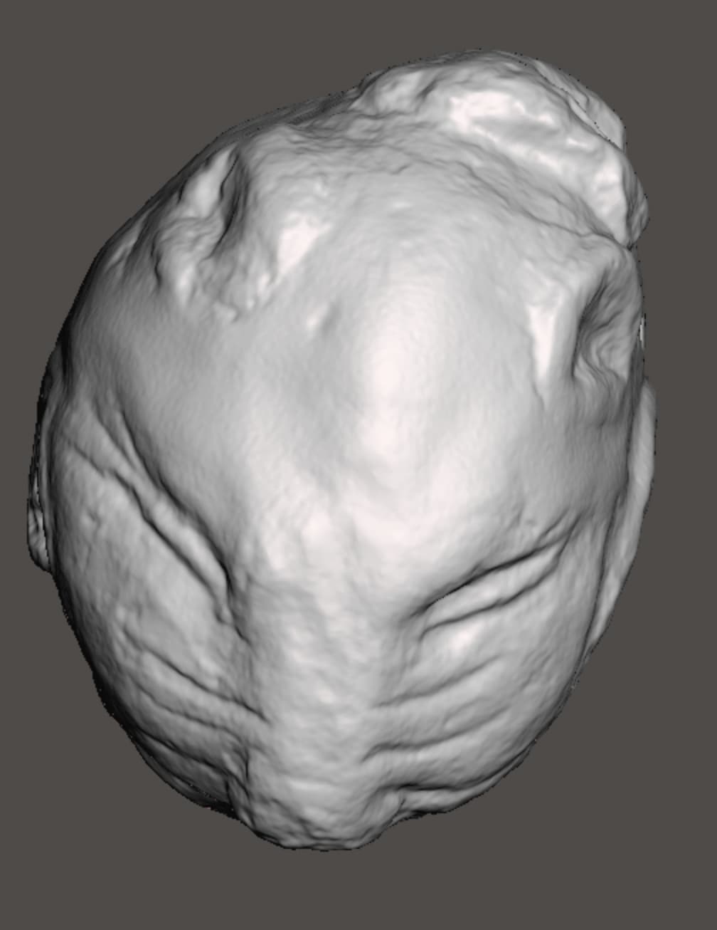

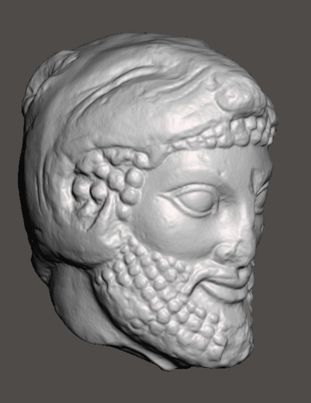

I processed the file obtained with Handy Studio to obtain the mesh. Finally, I applied the “smooth” command to the mesh thus obtained, and then saved the mesh obtained.

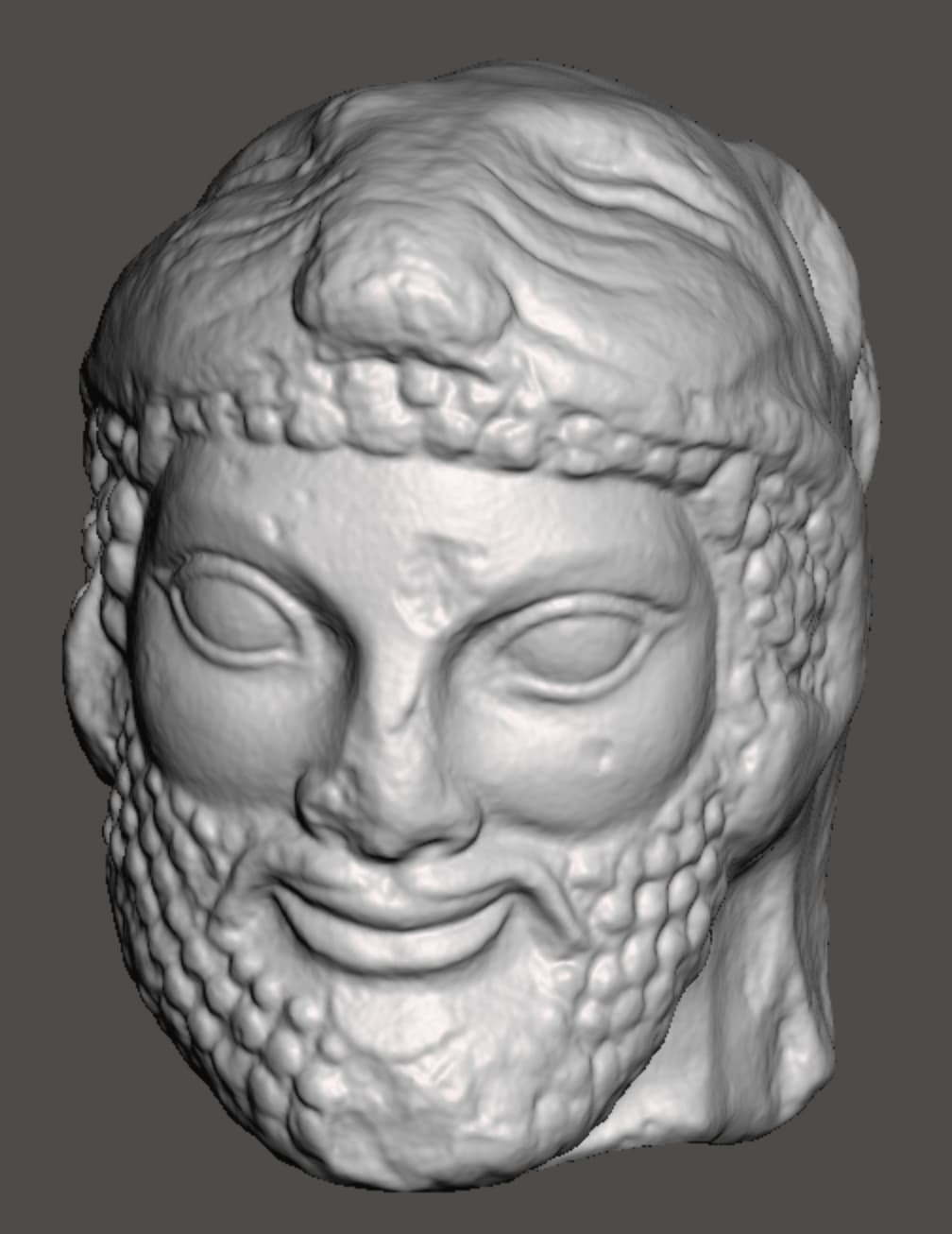

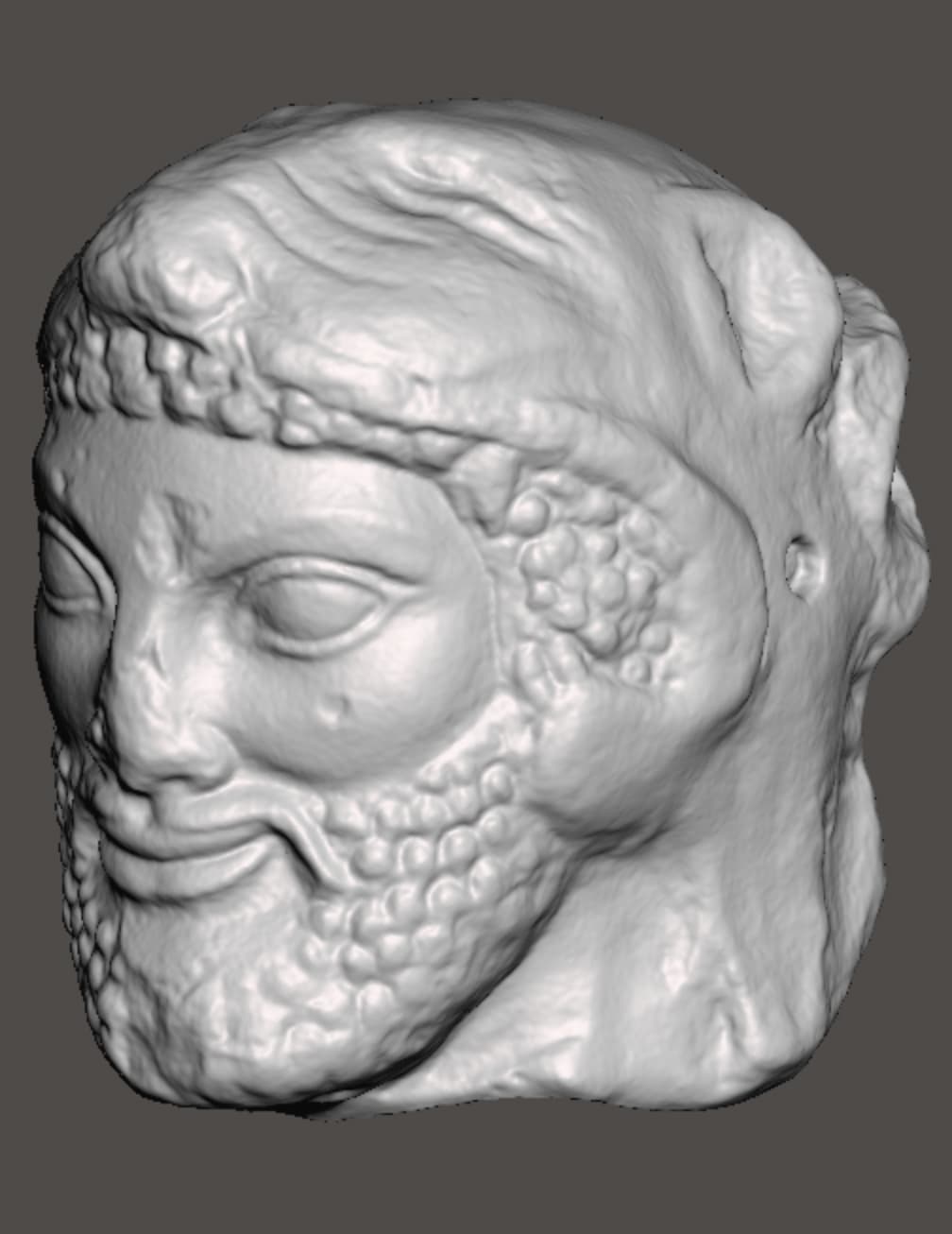

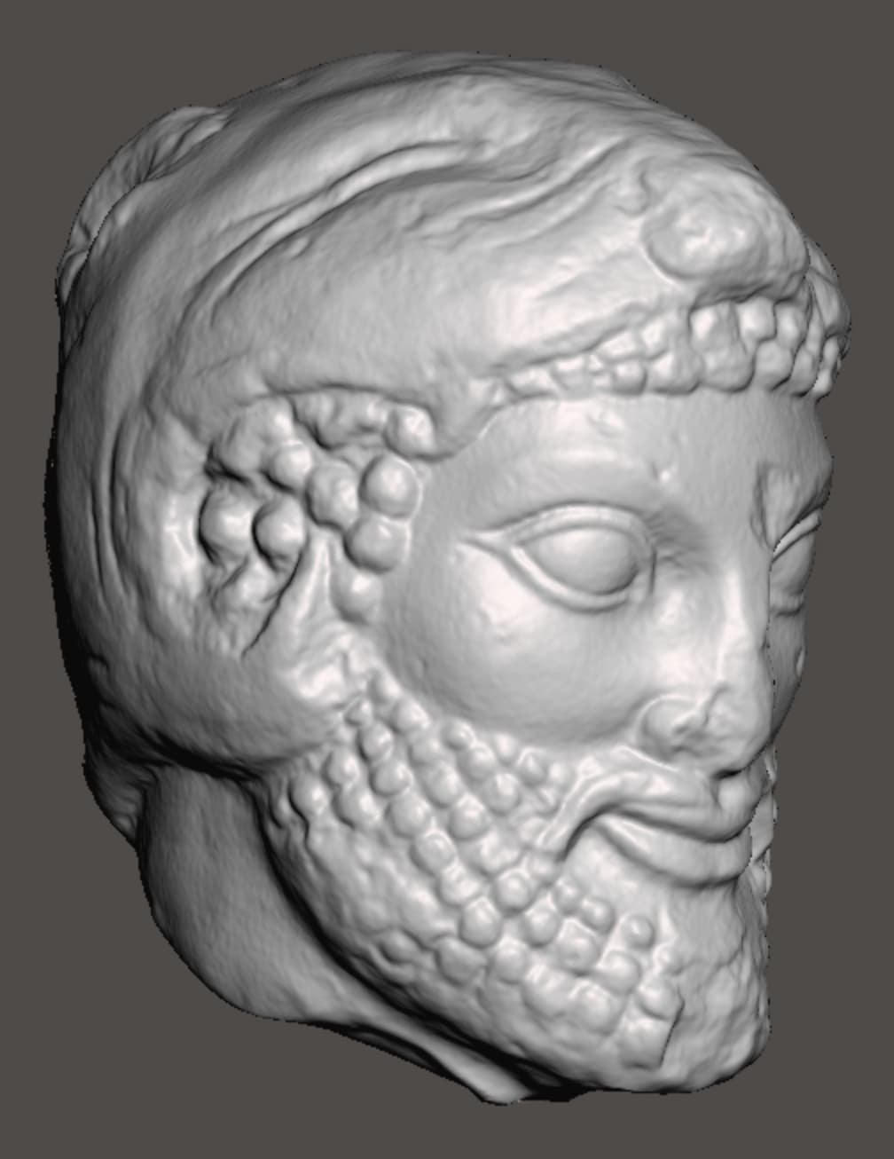

Below I present the result that I can define amazing:

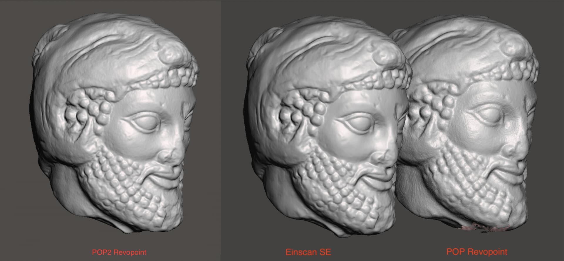

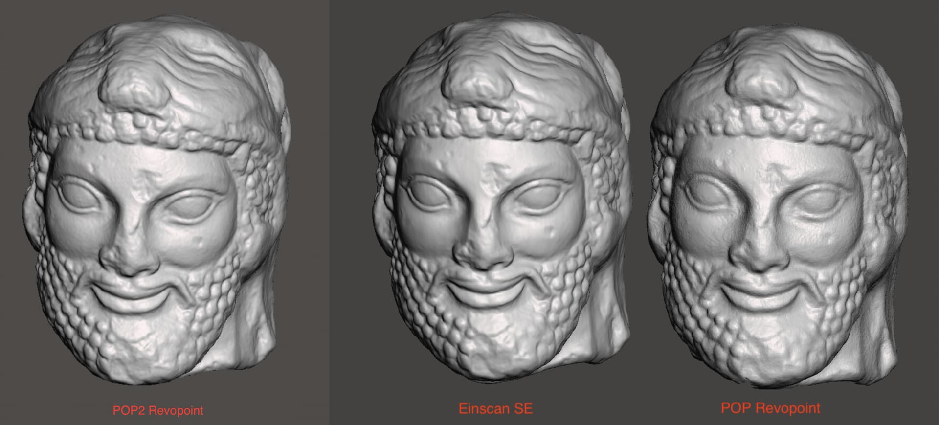

In the following images the comparison with the scans of the same sculpture made with EINSCAN SE and POP1:
