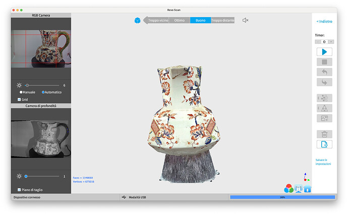

Today I have started a new project:
color 3D scanning of an antique vases collection
I used POP 2 with the latest software version for the first test. The intention is to do comparison tests with the MINI and the new two-axis turntable (which I received yesterday), but to do this I have to wait for the software update to be able to use it (scheduled for the weekend).
To scan, I used a light box and the speed controllable turntable.
I used for scanning the following setting:
Accuracy - fast scan
Scan Mode - features
Texture - color
I used for Fuse Setting:
Point pitch - 0.15 mm
I used for Mesh Settings:
Mesh Quality - 6
Denoise - 5
Fill Holes - yes
and after Texture mapping
For final editing (for removing unwanted scan parts) I used Revo Studio (last version)
Below are images of the various processes and the final result
Point fusion
Meshing
Texture optimization
3D model without texture
Texture mapping
Final editing

The new software allows the creation of a much better texture on POP 2
