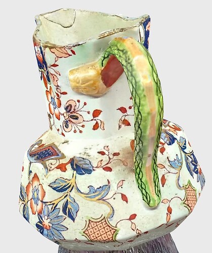

Good afternoon everyone,
and now a comparison: the same vase scanned with the new POP3 and the scan made with POP2
POP3 - Georgian era vase with rich decoration, colour scanning
POP2 - Georgian era vase with rich decoration, colour scanning
a picture is worth more than a thousand words

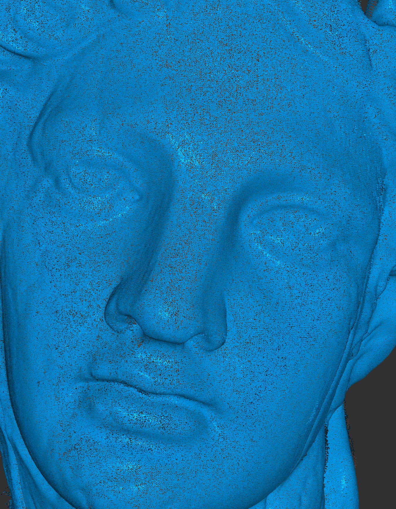

Good afternoon again,
I post another test with POP3 (with RevoScan 5.0.6 for Mac and Macbook pro with i7 and RevoScan 5.04 for IOS with iPhone 14 plus)
I scanned (re-scanned) an antique sculpture, about 70 cm high.
I made it in with RevoScan 5.04 for IOS with iPhone 14 plus. I proceeded as follows: scanned a portion of the surface, stopped and processed, then reopened and restarted the scan, added another portion, closed again, processed, reopened, and so on. It never lost tracking and the added portions aligned perfectly with the pre-existing portion: WOW!!!
Then I downloaded the project to the Macbook and performed all the fusing, editing, cleaning and etc. operations there. One note for meshing: in the latest version of RevoScan set to maximum (6) the result was a bit too smooth compared to the previous version. So, I exported the point cloud and then meshed with Meshlab and the result is as shown.
Below are pictures and the final result (amazing!):

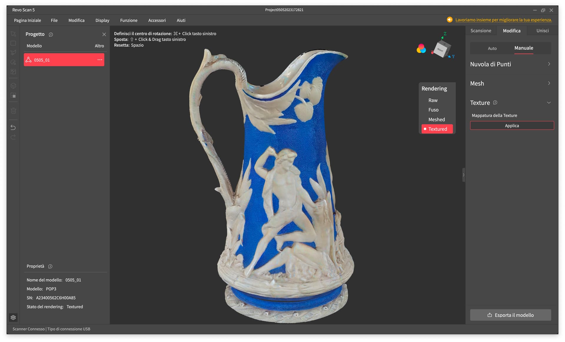

I post another test with POP3 (with RevoScan 5.0.5 for Mac and Macbook pro with i7)
I scanned an antique British jar, sculpted and painted (Wedgwood style), about 25 cm high.
I made it in only one scan: the jug was placed on the turntable and scanning was done by gradually raising the POP3 on the tripod.
All processes (editing, cleaning, meshing, texture optimization) were made into RevoScan 5.05
Below are pictures of the process and the final result, with and without texture:

Hey dfodaro!
Would you be able to explain in more details how you get such amazing result with Meshlab and give a step by step?
Hi Tom,
Thanks for your appreciation
In this case I imported the point cloud from RevoScan in Meshlab and there only created the mesh (no other editing)
Here a link to my old post were is explained my workflow in Meshlab (I hope useful for you)
