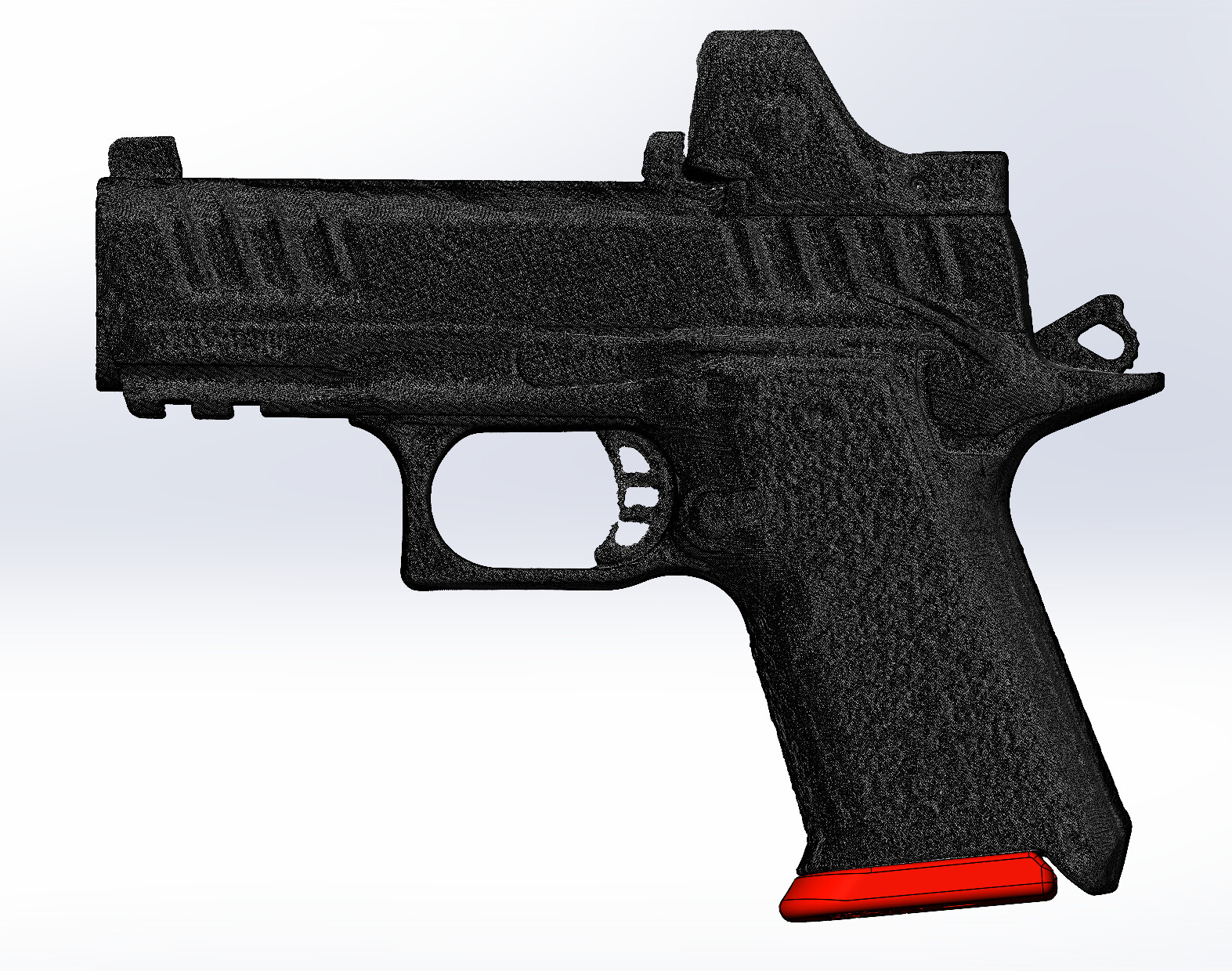

Then on to design. I didn’t do a full reverse engineering on this as I was able to capture the intent with cross sections

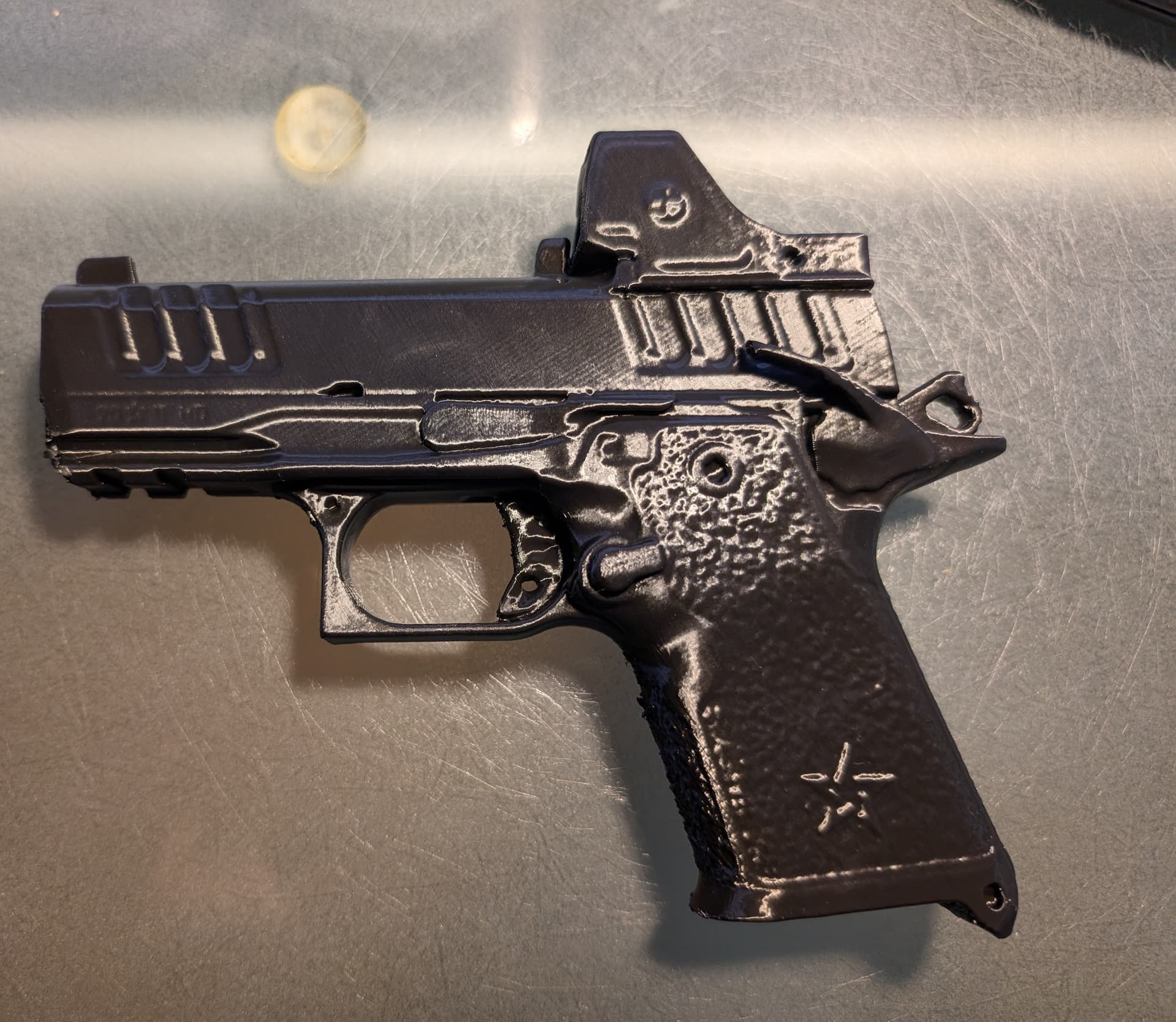

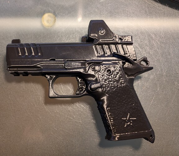

I wanted a dummy so I could have someone make a holster so I went back into mesh, made it watertight and sent it to the printer (while I was designing), this is the result. Turned out nicely. The Grip surface is like 80grit sandpaper and MetroX captured it well.
On to the final product.
not only does it help keep the pinky finger fully supported, but helps with printing too since the edge is a bit softer.
