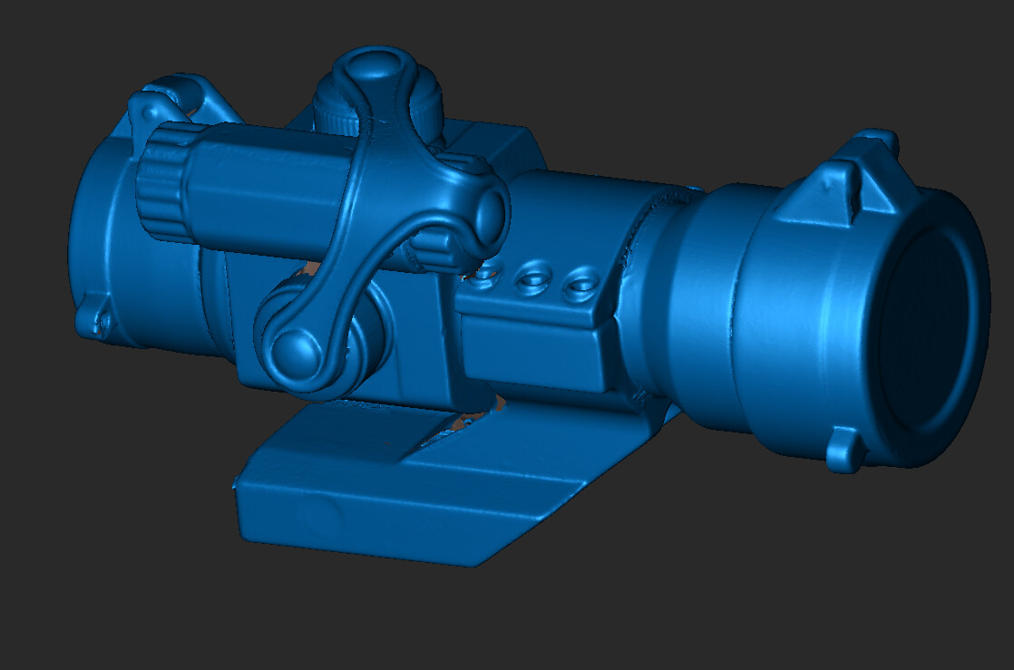

My last one for this thread is a SightMark RedDot. It’s more of a shiny black than the FLIR is. I had zero luck processing this w/o spray. Sprayed it, put it in full field mode and feature recognition and let it spin.
