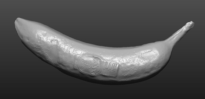

With bump maps created from color textures

Is the “bump maps from color texture” a function of the Miraco? If not, i wouldn’t showcase it as it may mislead about 3D scanning functionalty and accuracy of the scanner. One may think that it’s a 3D scan, while actually its calculated from luminance values of the picture, so it is no 3D information. Those bump maps you could do with any photo from any camera. The label on the banana shows it quite well. With bump mapping you create false 3D information in places where there is acutally none (the Text and the barcode).
That’s a common practice in 3D scanning :wink:
Typically, you start with your color map, minimize highlights and shadows, desaturate, and make various adjustments in Photoshop (like high pass filtering). Afterward, you import this new texture into ZBrush as a mask. On the highly subdivided version, you mask using alpha and inflate through the modified map. If there are multiple levels of subdivisions, you can morph target the original low-res version to restore the original volume while retaining the details from the newly generated bump map. While the Miraco delivers fantastic geometry details, in 3D, there are always techniques to delve even deeper into the process for an even better outcome.
That’s why i asked if it has anything specifical to do with the Miraco. And apparently it has nothing to do with it. The question here is what has been done on the machine to understand the capabilities of it and not what can be done on a PC later with postprocessing. The problem with their kickstarter camapaign so far is a lack of sample 3D data directly from the Miraco.
The beta unit I possess generates geometry and color maps without producing bump maps. However, you can utilize the color map provided by the scanner and easily desaturate it to serve as a bump map outside of the scanner with just a few clicks if necessary. The inclusion of a bump map for the banana was merely intended to demonstrate the intricate details achievable with a quick adjustment. It was never promoted that the scanner could generate bump maps, and the description accompanying the image clarifies that the result is obtained using the color map as a bump map. The cookie scan illustrates the remarkable level of detail and resolution that the scanner is capable of capturing.
Why it misleading when I stated I created it from color textures , so what is now misleading about showing a bump maps ?
A lot of people was interested to see if they can improve the surfaces using bump map from color map .
A lot of 3D artist create alpha maps from color maps to improve the details of a surface , of course some things have to be masked.
Don’t need to split the hair in half here .
It is just an example for those that was interested .
BTW am doing this work for 26 years , not need to explaining .
Thank you Julien, that was exactly the purpose here . You can extract normal map and displacement map outside as well from the mesh , fot many other purpose if needed , but you are pro, so you know it and recognize the all possibilities .
The cookie don’t have any bump maps other wise it would stated so .
