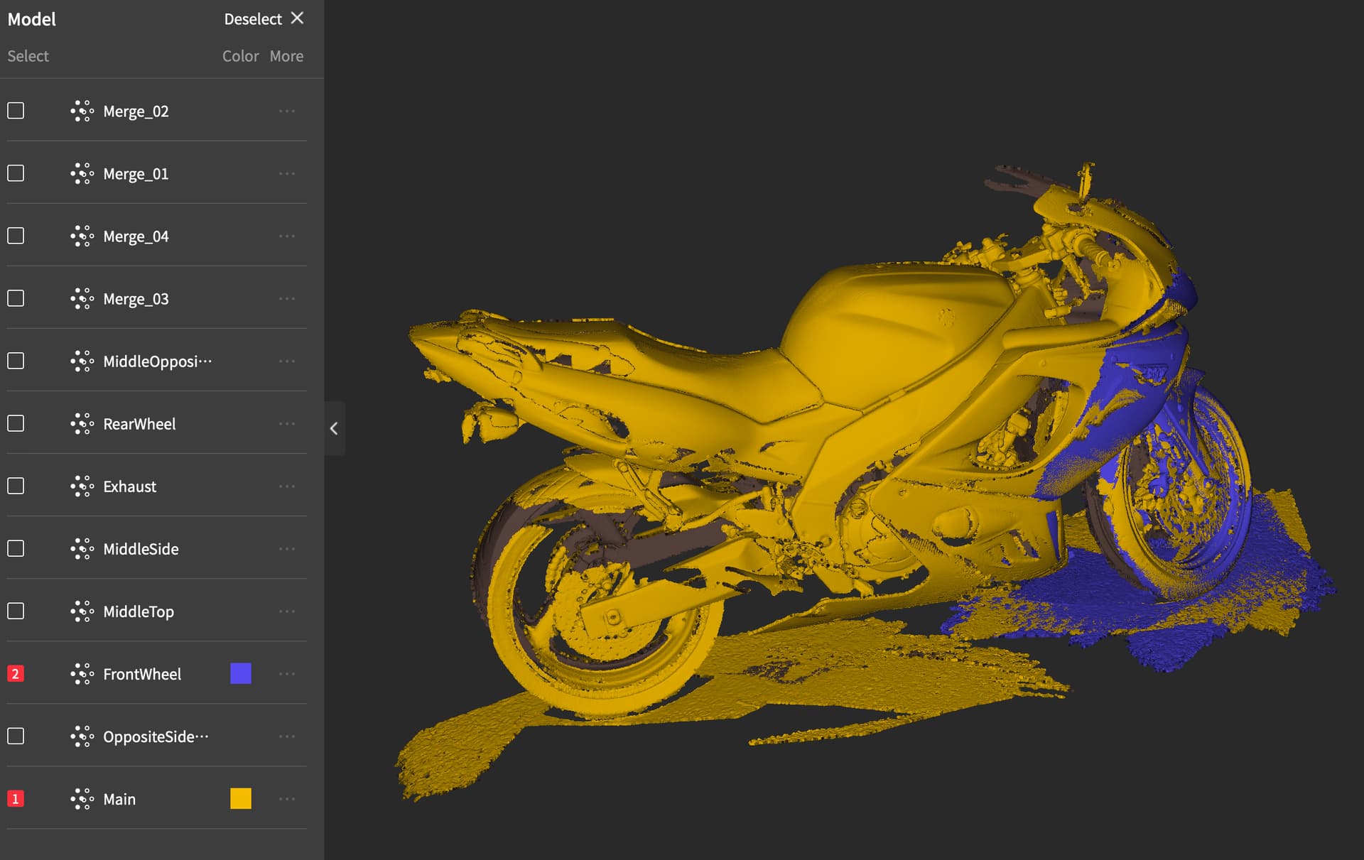

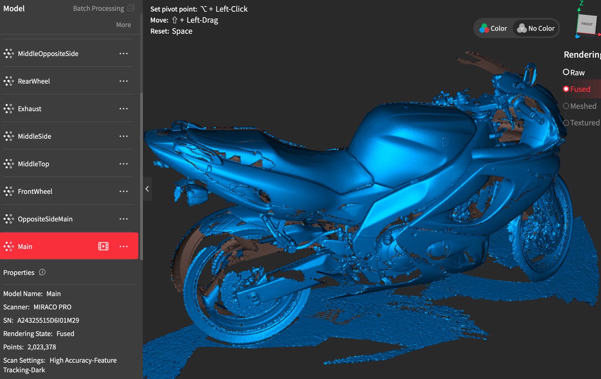

Before Merge:
During Merge:
After Merge:
The result is a significantly worse model (even on parts that shouldn’t have been touched by the merge). This makes the merge tool unusable for when you need a high detail point cloud.
This is on MacBook Pro, 64GB of ram.

You need to remove and clean the scan from everything that do not belongs to the bike to successful merge it, this means you need to clean out the floor , any overlapped or lose points . Fused point cloud only
Additional stuff like floors or any elements that do not belong to the object you are scanning will interfere with proper merging .
The merging function use face recognition algorithms, anything that do not belongs in the scan will set it off resulting in false results.

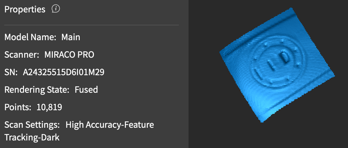

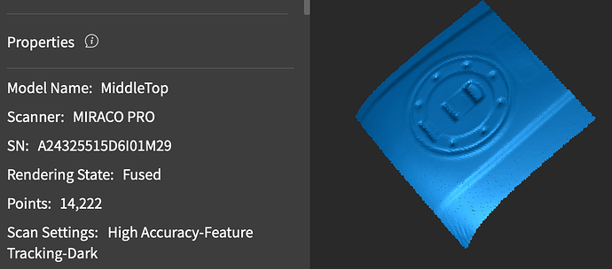

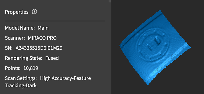

Issues in my scan aside, it’s applying some sort of smoothing, reducing the detail of the scan.
Here it is on a “processed” section. Same issue
Before 1:
Before 2:
After merge:
So there is definitely a bug causing some smoothing over the entire model. The output looks far worse than both of the inputs. Even when I fix everything you mentioned (as I did with both of these inputs prior to merging)
