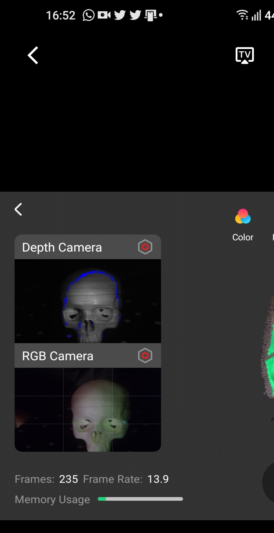

Mini FPS 13.9 on Android RS v.5.0.2
Via WiFi , well surprised it got above 10FPS
With IOS there is no choice but WI-FI.
Using WI-FI on win 10 desktop 11.5 FPS.
IOS 7 FPS.
