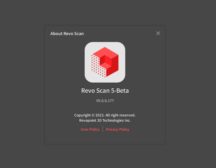

Add a “Copy Version Number” to Help - About Revo Scan.
It would be even better if a copy function is built in where all relevant data is copied, such as the operating system and the scanner or everything that is integrated into the system hardware.
Thanks for the hint. I tried that yesterday, but it’s very cumbersome. is at the moment but probably the only solution for me.
