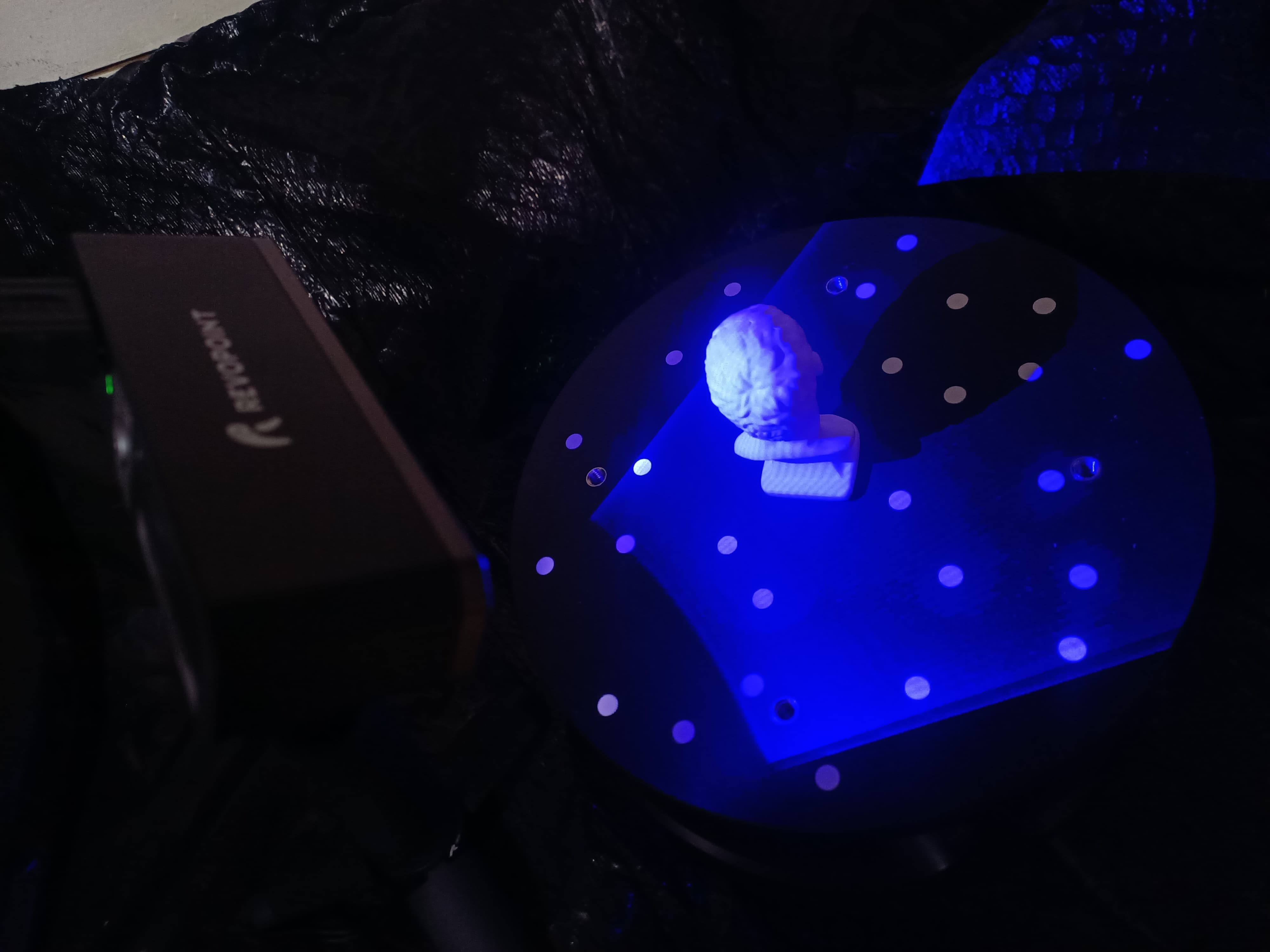

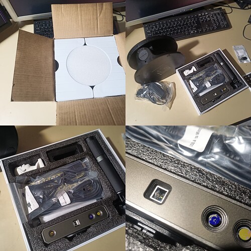

I received my mini yesterday.
I downloaded the new Revo scan software and did the firmware update just as the directions outlined.
I was able to make a couple scans before I left for work today using the dual axis table and everything worked as it should.
I also took a couple infrared photos of the mini just to see what the heat build up would be like after an hour of operation.
It got up to almost 41° c and stabilized with an ambient Air temperature of 20° c
The one complaint I had was one of the lenses seems to have dirt or glue sandwiched in between the layers I don’t know if it’ll affect the accuracy of the scan ? @Revopoint3d-Selina

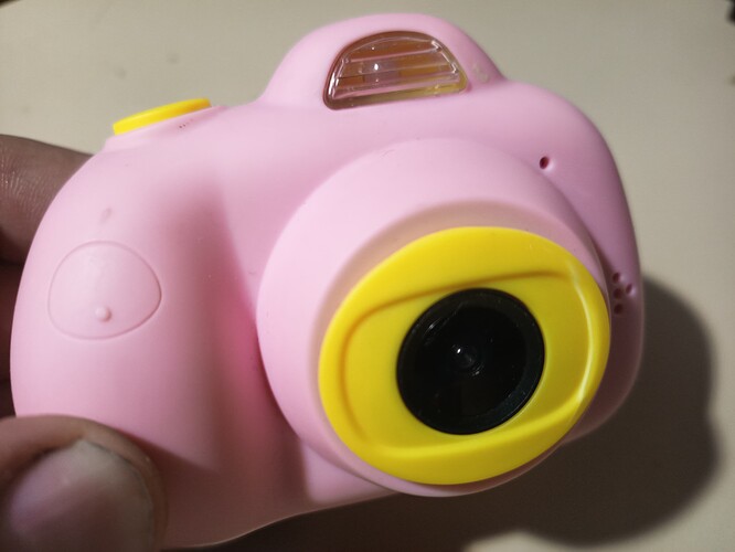

And an observation I made at is that this color yellow is completely invisible to the mini.

That is the RGB camera , make a color test to see if it affect anything , very rare …
This kind of yellow definitely, yellow and any colors that have yellow like brown, orange and green will be affected as they absorbing blue , you will need to increase the gain settings to be able to capture the objects with those colors , sometimes it will not works like green from a plant as I was not able to scan pineapple but was ok scanning my bath duck lol the gain was on 10 .
First scan all colors as usual then next rotation use gain at the proper brightness to capture the rest of the colors that was not captured in first place .

Yes, that is glue, which won’t affect the accuracy of the scan. Every device may have a similar situation. Please don’t worry.
