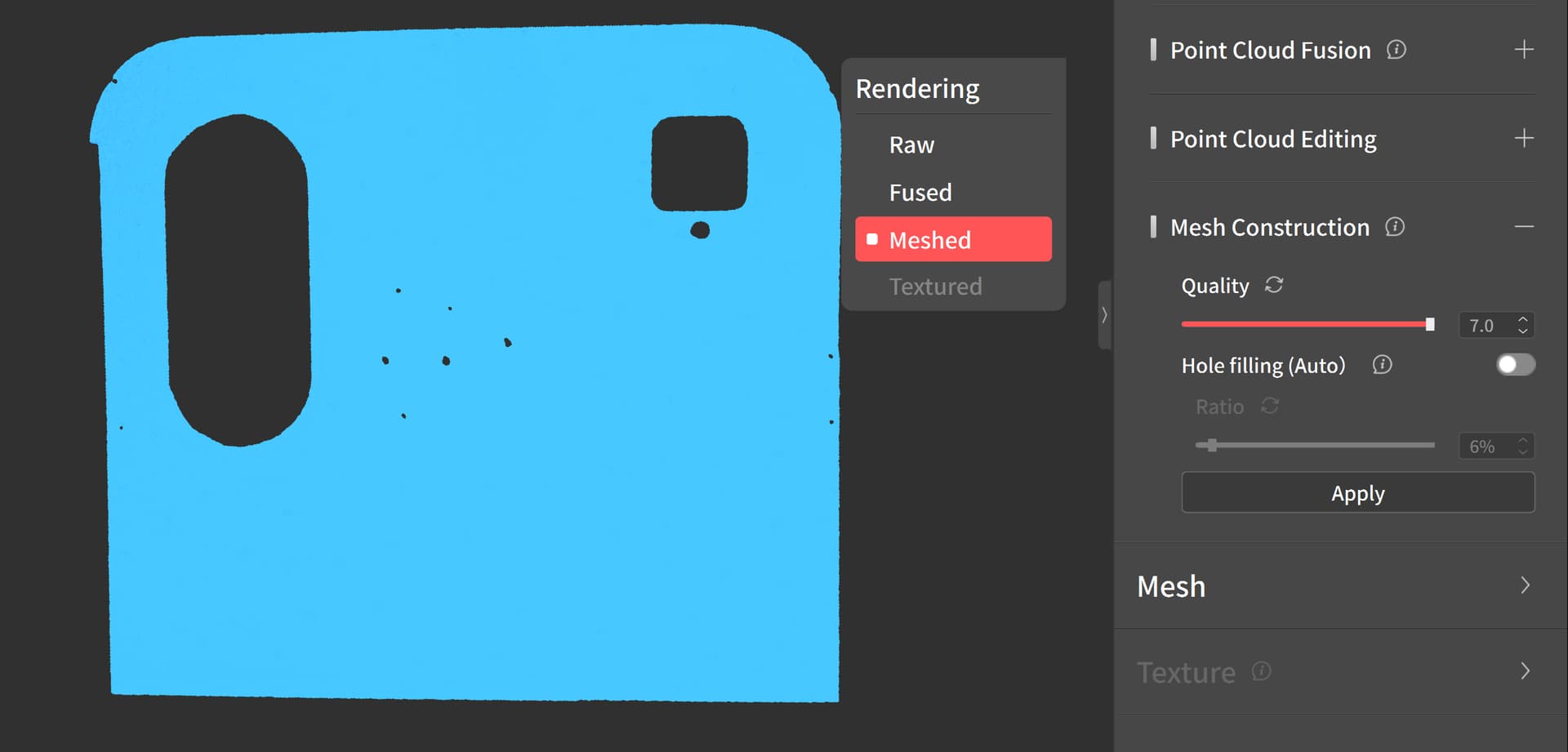

The part I’m trying to scan has 0.25" holes in it. The part is about 34"x30". When I convert it to Mesh, it fills in the holes. I’ve tried adjusting the “Hole Hilling Auto” settings (and without it on), but it just gets worse. Can it not handle 0.25" holes?

As shown in your image, the hardware is perfectly capable of scanning the features but the meshing side of the software doesn’t seem sensitive enough to handle such fine features.
The holes are too small for this meshing functionality under the profile of Range , it only uses very low % of the actual point cloud while meshing , other wise you would have a monster model in size .
Try to mesh the fused point cloud using Cloud Compare .
