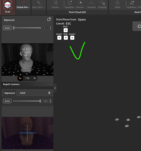

Scanning with global marker tracking even the lowest exposure setting is too high (both auto and manual), experiencing it with both with pop2 and miraco in pc-mode. When switching back to normal scanning mode (without global marker tracking) exposure settings are normal and way lower , as usual. :thinking:

I redid my testing today and only seem to have overexposure even on minimal exposure setting only on miraco pro (pc mode, near, picture lowest right). Same object with my other scanners at about optimal distance the minimal exposure is much lower and can be adjusted as needed on auto and manual.
