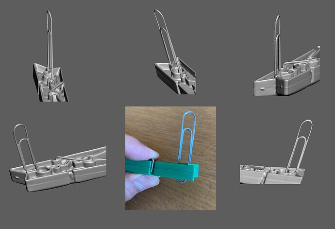

I have started to familiarise myself with the new MINI 2. As an initial test I scanned an paperclip. The paperclip was prepared with a 3D scanning spray.
The scan was carried out by placing the object on the turntable and scanning in continuous mode.

Below the version made with the MINI 1.
In that case, I had taken two separate scans, which were merged later (the FOV being smaller than the MINI 2, tracking was lost by doing a full rotation).
In the case of the scan carried out with the MINI 2, this procedure was not necessary, as full rotation was performed. The RAW data was cleaned before fusion and then meshed.
Comparing the two scans, it seems to me that in the MINI 1 version the paperclip thickness is thinner than in the real object, whereas in the MINI 2 version this is not the case. See the picture below.

was it the same scanning spray and applying method used on both paperclips? Which scanning spray(s) have you used?
Did you measure the deviation on scanned thickness vs true thickness?
Best regards
Thanks Ivan!
the spray is Aesub (long-lasting)
To make this measurement I would have to look for the file of the first scan (I don’t know if I will be able to retrieve it).

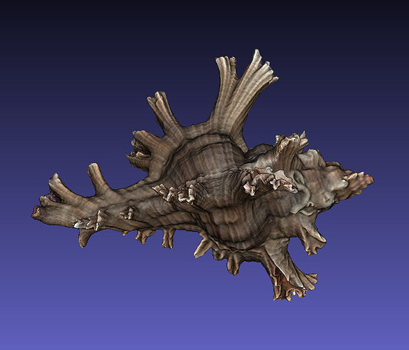

Hello everyone,
now a scan (in colour) of a sea shell, with fine detail.
Scanned on the turntable, performing full rotations and changing orientation.
Daylight, flash off.
Get your MINI 2 here:
Global:https://revo.ink/49xqHnv
US:https://revo.ink/3OKKiYK
RevoScan
RAW
FUSED
MESHED
VIDEO
SIZE - in mm
MeshLab
MeshLab color

Hi Davide , I was waiting for your clip ! :blush:
But MINI 2 can go already beyond that what makes its Accuracy much better than specifications sheet .
Keep up the good work !

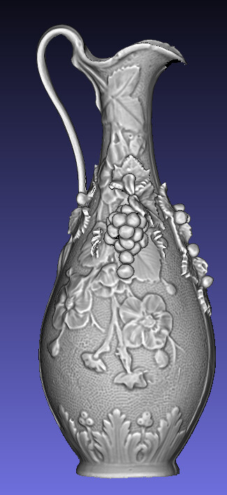

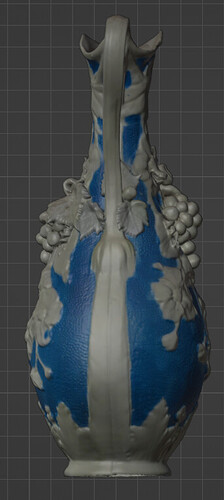

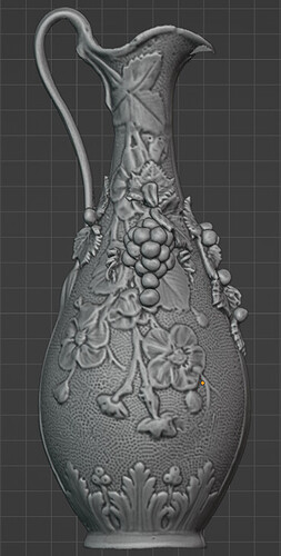

Vase Scanning with MINI 2
Vase Blue & White with rich grape and flowers decoration
SIZE - in mm
MeshLab
Blender

From a paper clip to a Jug. Would you say the improved larger FOV helps?
The wider FOV was essential to facilitate scanning . The scanning of the vase was done in a single session, using the turntable and tripod, raising the scanner after each turn.

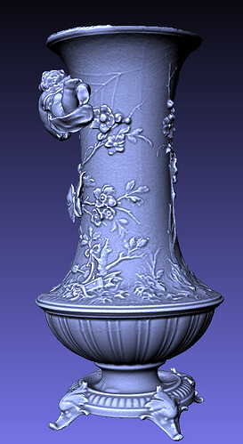

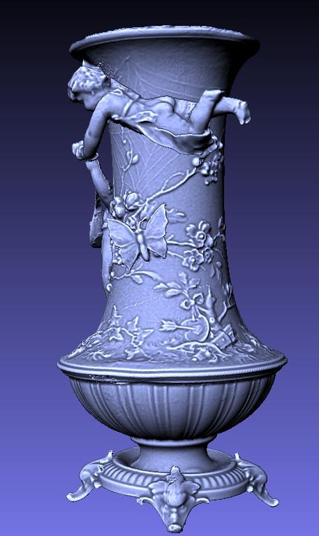

Ancient Pewter Vase with putti decoration
RevoScan - Poin Cloud
RevoScan - Meshing
RevoScan - Hole detection
RevoScan - Fill Holes processing
Size - in mm
MeshMixer
MeshLab
CloseUp

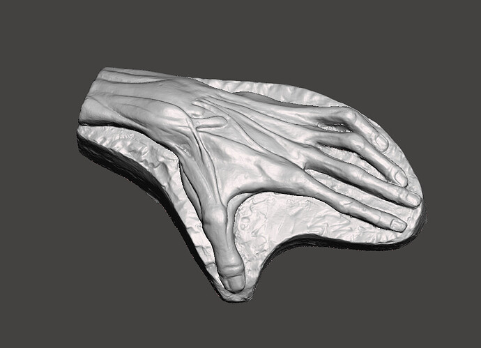

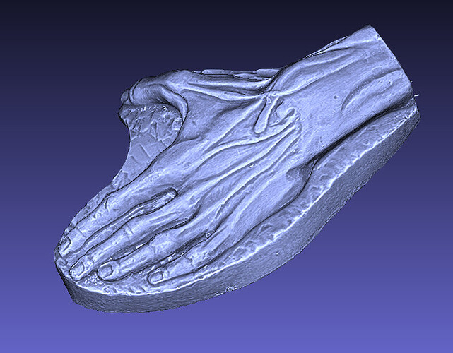

Hand Anatomical Plaster Cast - Skinned (Scorticato) Type
Size - in mm
RevoScan - two scans merged
MeshLab
MeshMixer
