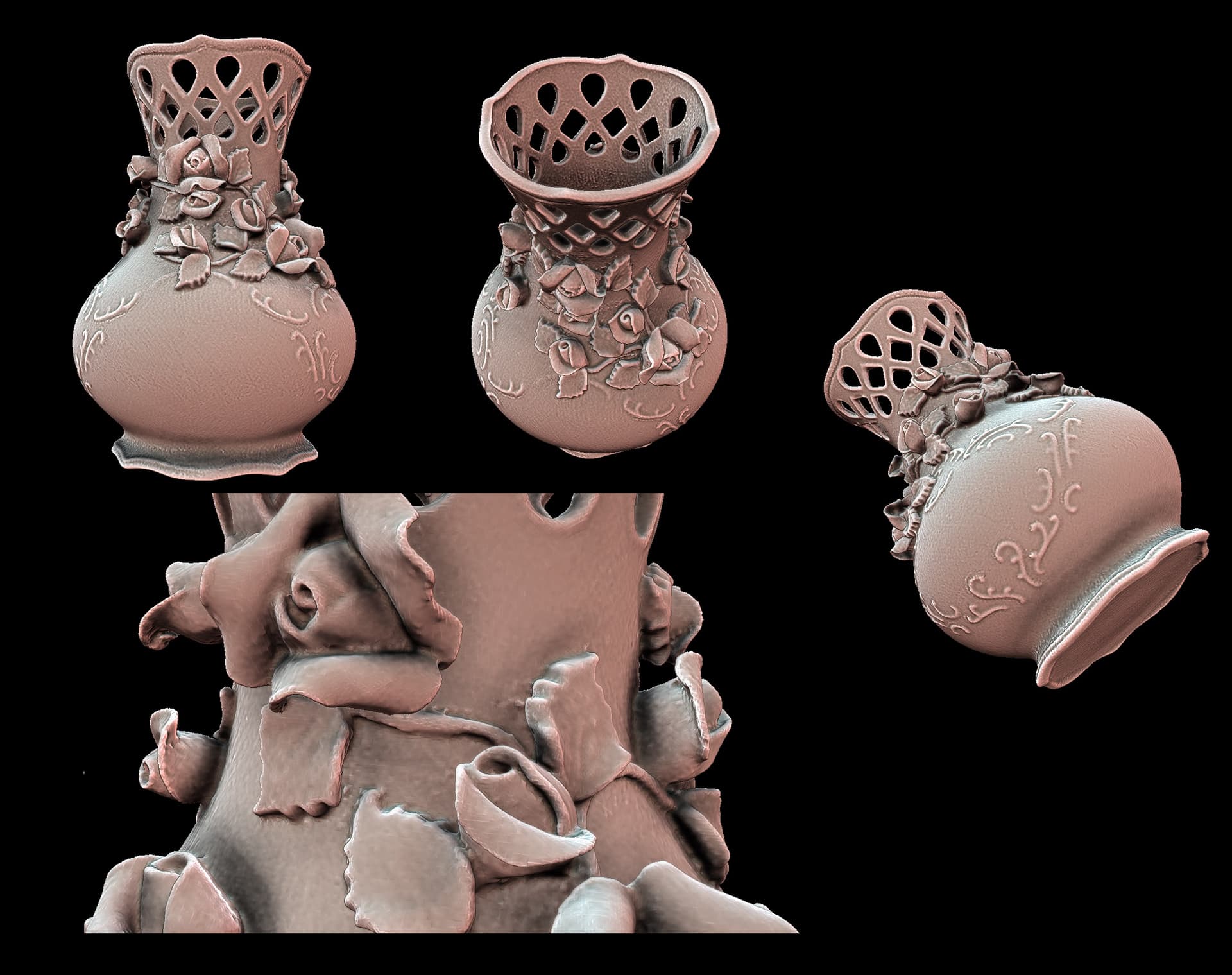

A very shiny glazed, porcelain vase. Two orientations of 9000 frames each. Scanned in Laser cross lines mode, reflective metal mode.
Meshlab
Render
SketchFab

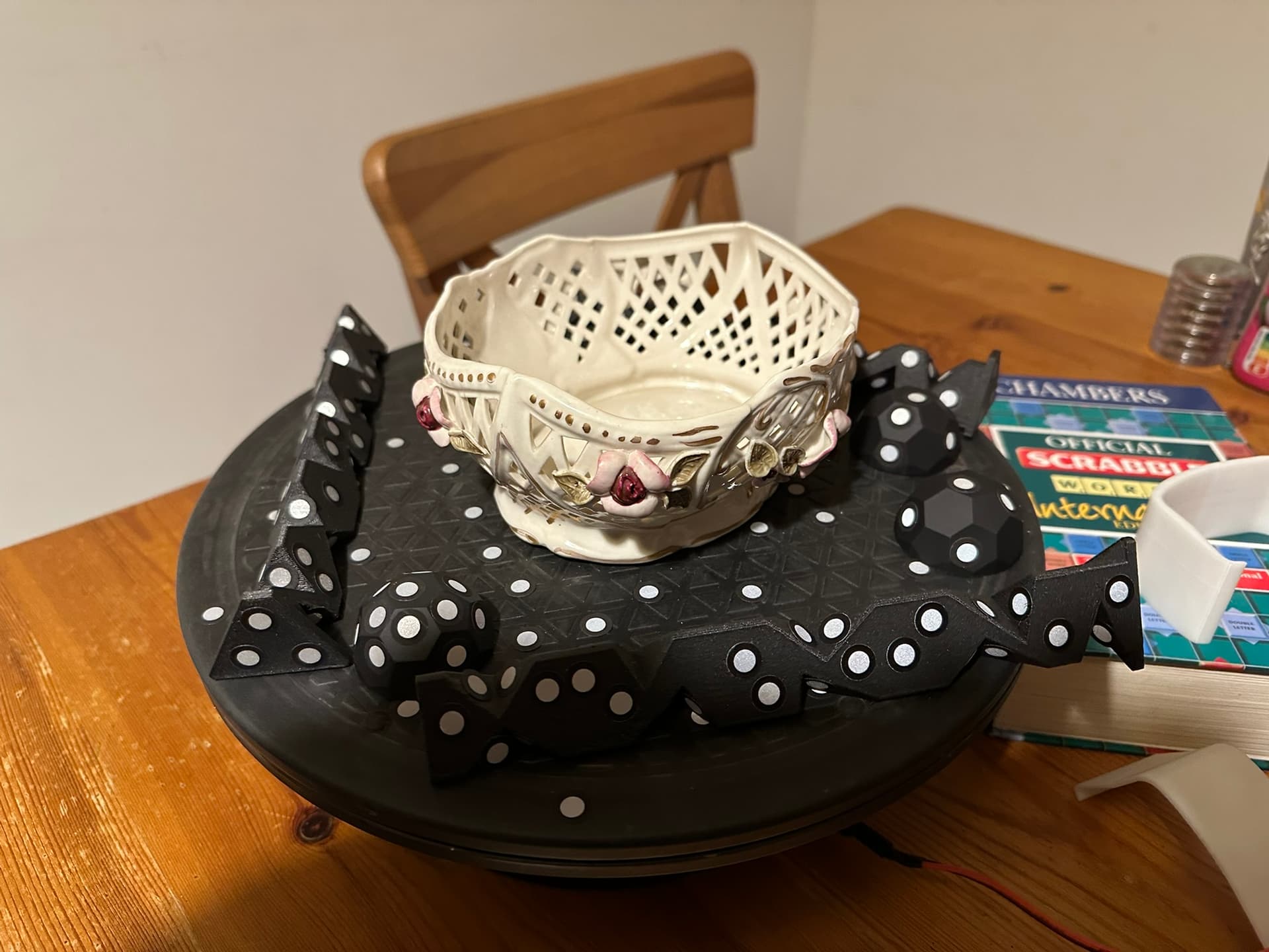

Ceramic bowl from the same set as the vase I posted before. Very shiny with a glaze on it.
Scanned with no spray. Just makers around the object.
Scanned in parallel lines mode, hand-held.

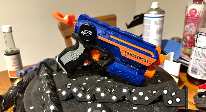

Shiny plastic Nerf Blaster - 250mm long.
Scanned in crossed lines mode. Black object settings.
