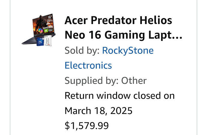

I got my in February on Amazon for use with Beta Trackit scanner
2 other of my friends got it too, great little beast and performing better than my workstation . Sadly this promotion is not more available . But you can search Amazon , the only one I see are with i7 13 Gen
Acer Predator
i9 14th Gen, 64 GB RAM, RTX 4060 8GB, 2 TB SSD
