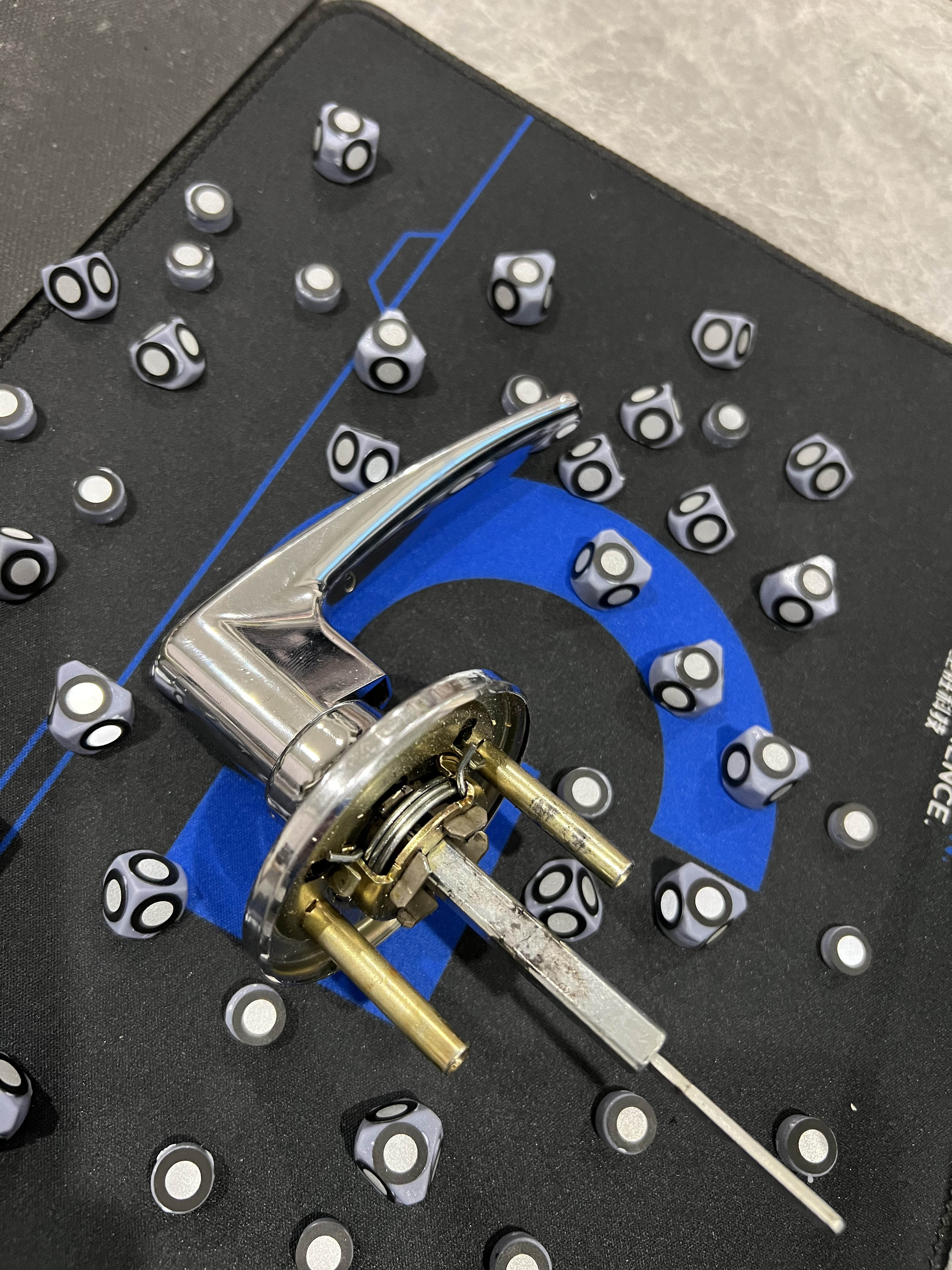

Scanning Shiny Surfaces
Example Scan: Door Handle
Material: Silver reflective surface.
Tips:
• Adjust the scanner settings to handle reflective surfaces.
• Use cross laser mode for capturing intricate details on shiny objects.
• Work in a controlled lighting environment to minimize interference.

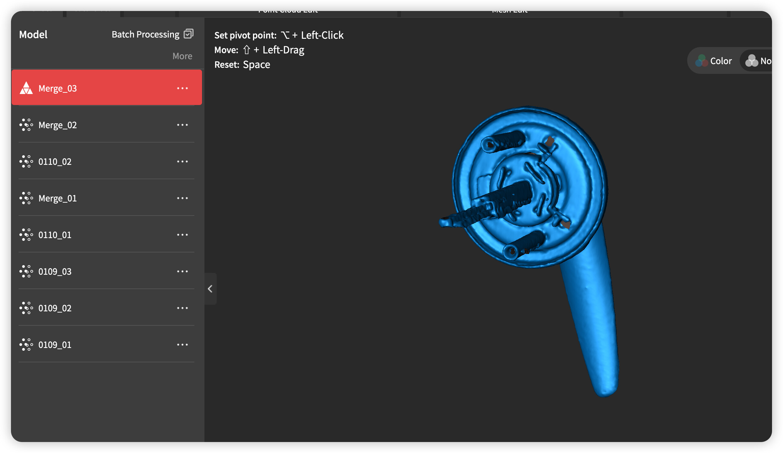

Scanning Mixed Surfaces
Example Scan: Door Lock Module
Material: Combination of reflective and non-reflective metal surfaces.
Tips:
• Optimize scanner settings for mixed materials to ensure consistent capture.
• Perform scans from multiple angles and merge them for a complete model.
the scan result can be smoother, if for more frame, at least 9000 frames taken
as this only show the power of scanning ability of MetroX
