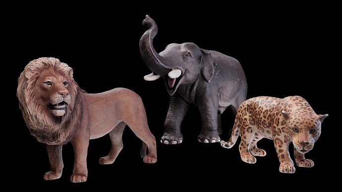

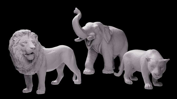

Some of my daughter’s Schleich animals. Auto-turntable with marker tracking. Textures and geometry all straight out of Revoscan with lighting and rendering in Maya.

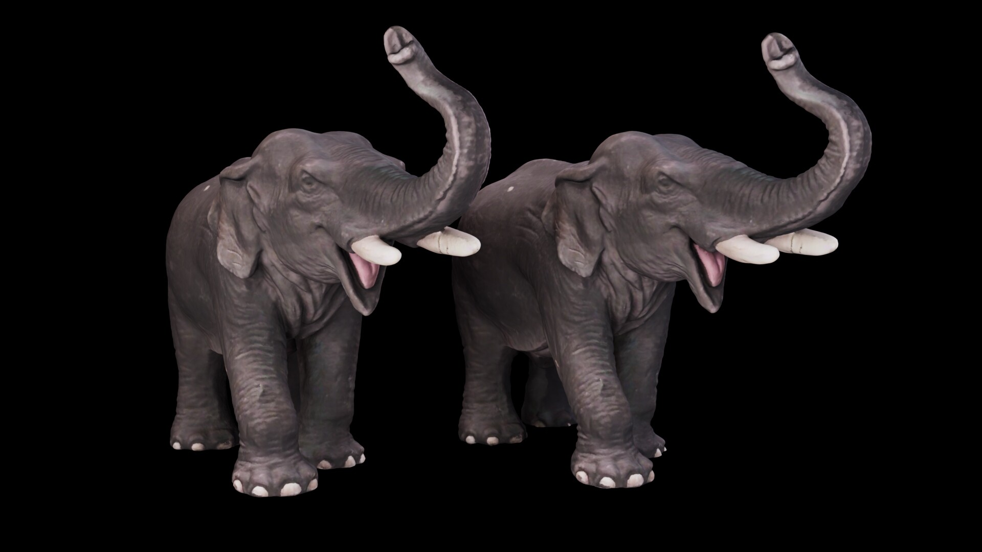

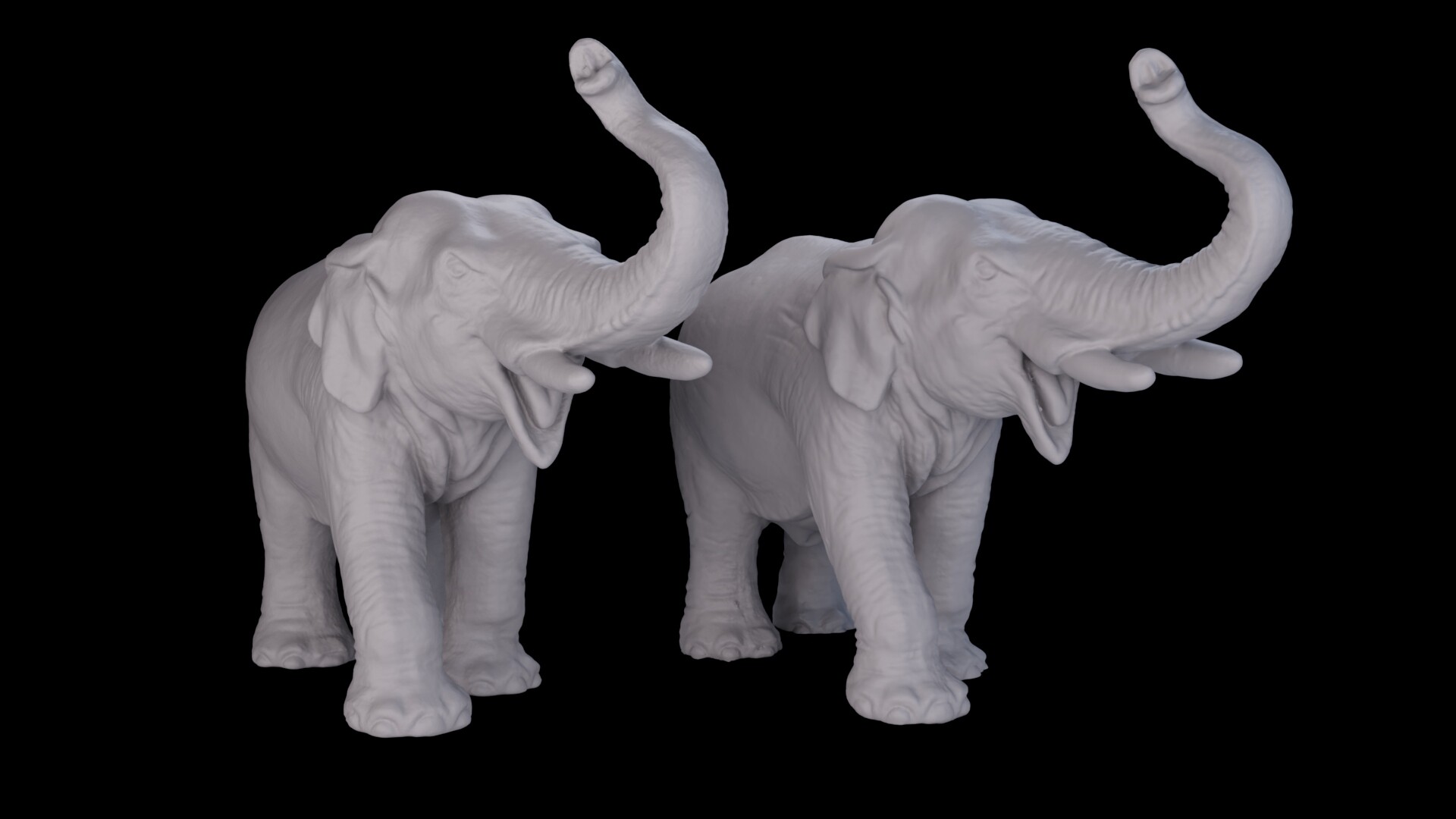

One of these elephants was scanned with auto-turntable, the other with crossline laser. I transferred the UVs and texture from the auto-turntable scan to the laser scan. Which is which?
edit: fixed the exposure of the untextured version
It would be very hard to detect as they are basically the same UVs and Text data.
But really good seamless job on the transfer.
But I will guess saying the left is the transfer and also cross laser scan… Based on some factors
Correct!
My thoughts are the laser did a better job on some of the deeper, harder to access features, whereas the broader areas show more definition in features like the skin wrinkle with auto-turntable.
It was a very hard quess , you did really great job with the laser scan, almost invisible differences what is fantastic , guessing from a picture almost impossible.
The level of the details on the objects are very good in comparison including the color data.
Well done !
Yeah the Auto turntable mode uses different technique while scanning than the Full Field or laser mode so it require all angles to be captured well and if possible at the same distances possible for the best result , even 10-20 mm distance could make big difference in final results so good planing on the rotation steps is important to get the full exact results at any angle .
With a lot of blind spot on that object it can be little time consuming to find the best angle.
But you did really nice job on it.
Not to mention it is probably resin or plastic material with acrylic paint .

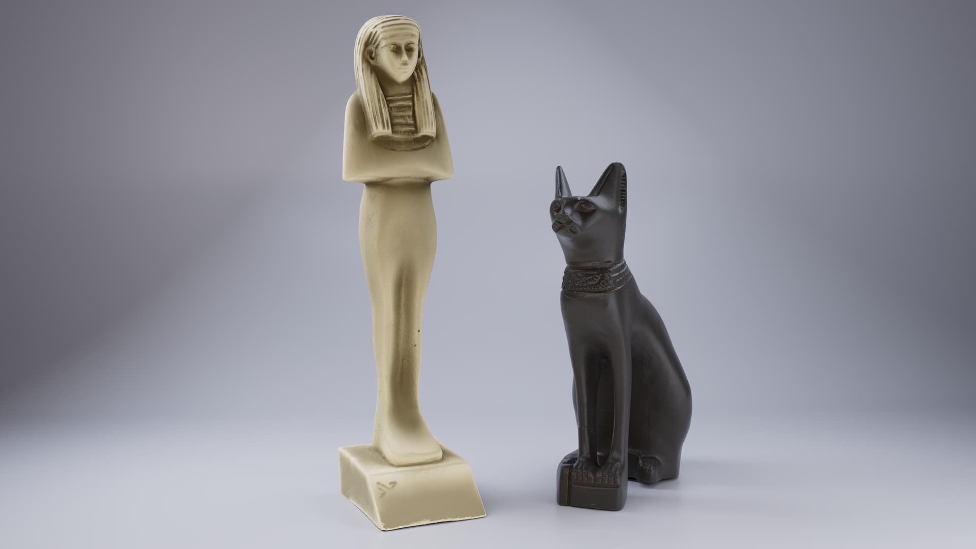

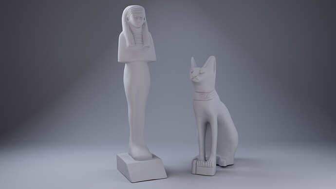

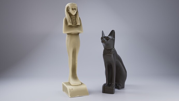

Egyptian statues (they say “Made in Egypt” at least). Mummy figure is ~11" tall, cat figure is ~7.5" tall.
Cross Lines laser mode. Rendered in Maya with a quick shader to approximate the original.
