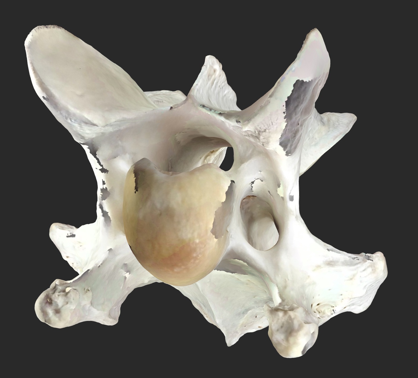

I’ve encountered this now in a couple of the scans of my horse bones. All looks good in the Mesh, but when I apply the texture holes appear.
Any work around? or do I just scan again? POP3 Revoscan 5.2.1.4

ADDENDUM: Since I posted this, 4 out of the 5 scans I ran today had the same issue with holes appearing once the texture was added. :frowning:

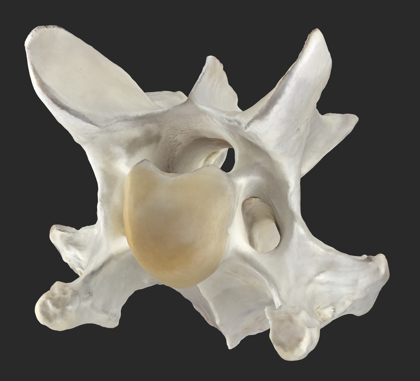

I’m getting my workflow down nicely and am getting lovely meshes of the bones. A couple of the bones took only 2 scans to get a usable texture file. I can deal with this when its just the colors that are funky, by editing the .txt file in Adobe Lightroom. What I can’t do (because i don’t have the technical skills yet) is fix the holes.
I scanned this bone 3 times and each time the txt file had too many holes, some large. You can probably understand my frustration when you see how nice the Mesh is!

please install back Revo Scan version 5.2.0 , the latest version have bug so you may get not as good results , the RS 5.2.0 provide the optimal merging and may help you out with your texture issues , please try to work with that until the current bug is fixed and new version is available .
