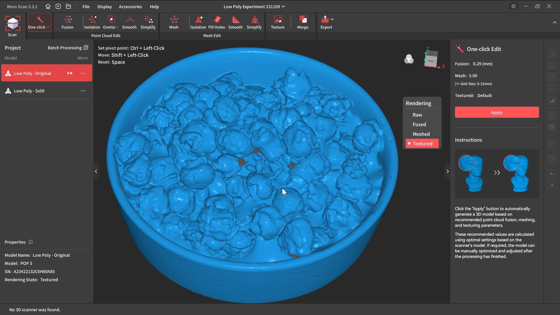

Saw an interesting post on Reddit using Textures to provide apparent detail to a low-poly object. The original poster wanted a final file size of 5 MB to display products on a web page with lower bandwidth requirements.
I had a few minutes this afternoon to experiment with my POP 3 and Revo Scan V5.3.1 on my Windows laptop.

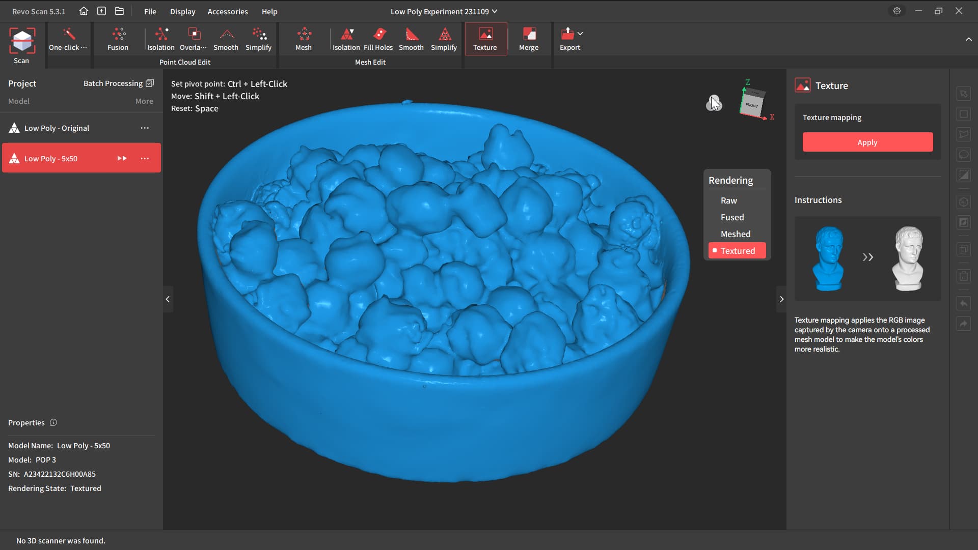

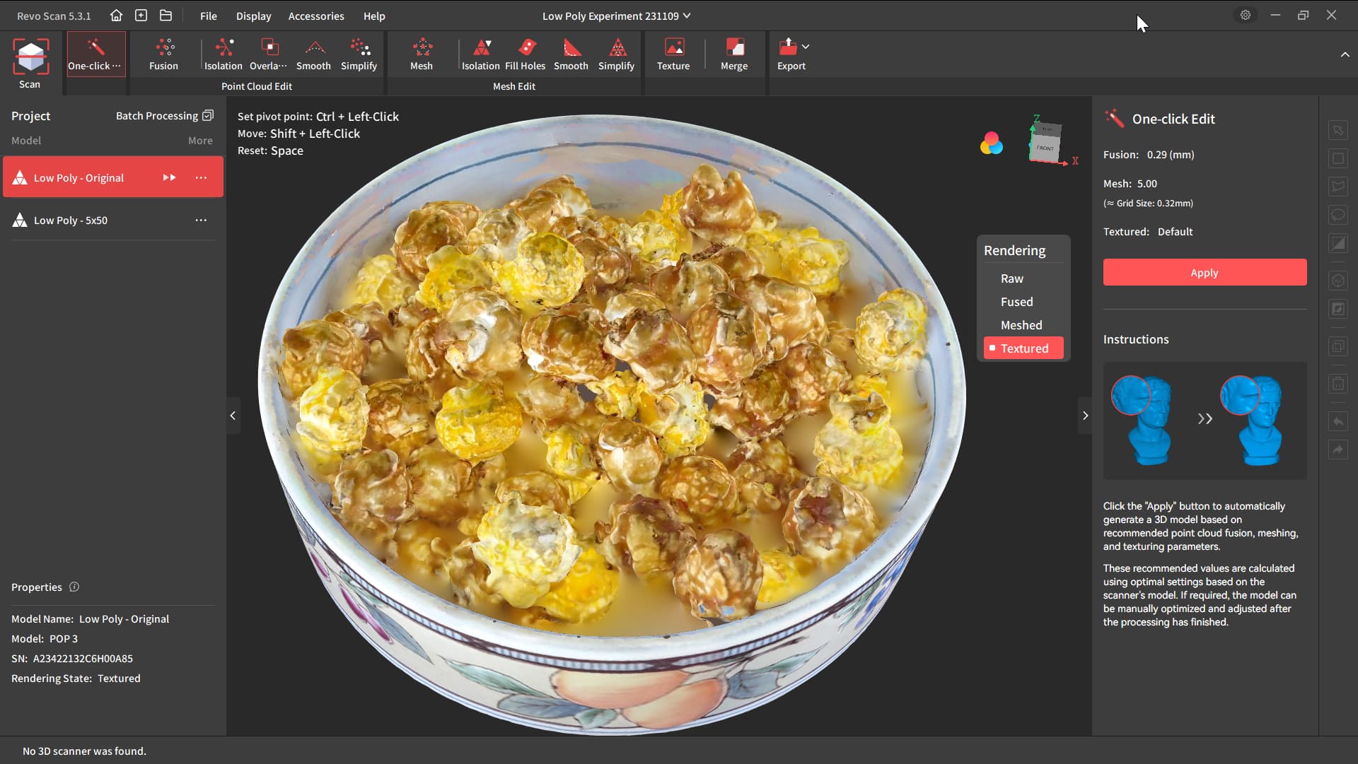

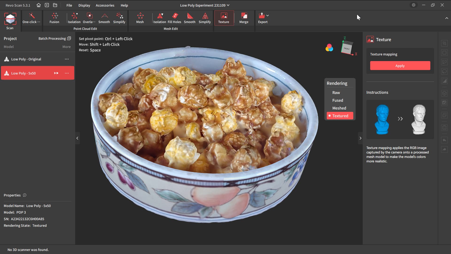

I scanned the same bowl of popcorn twice and used Simplify 5 times at 50% for one of them. Here are the results.
The Fused objects
The fully-textured objects, but without color
The results are reasonably close, but there is room for improvement (especially during the editing process).
The file size comparison (a 77% reduction).
