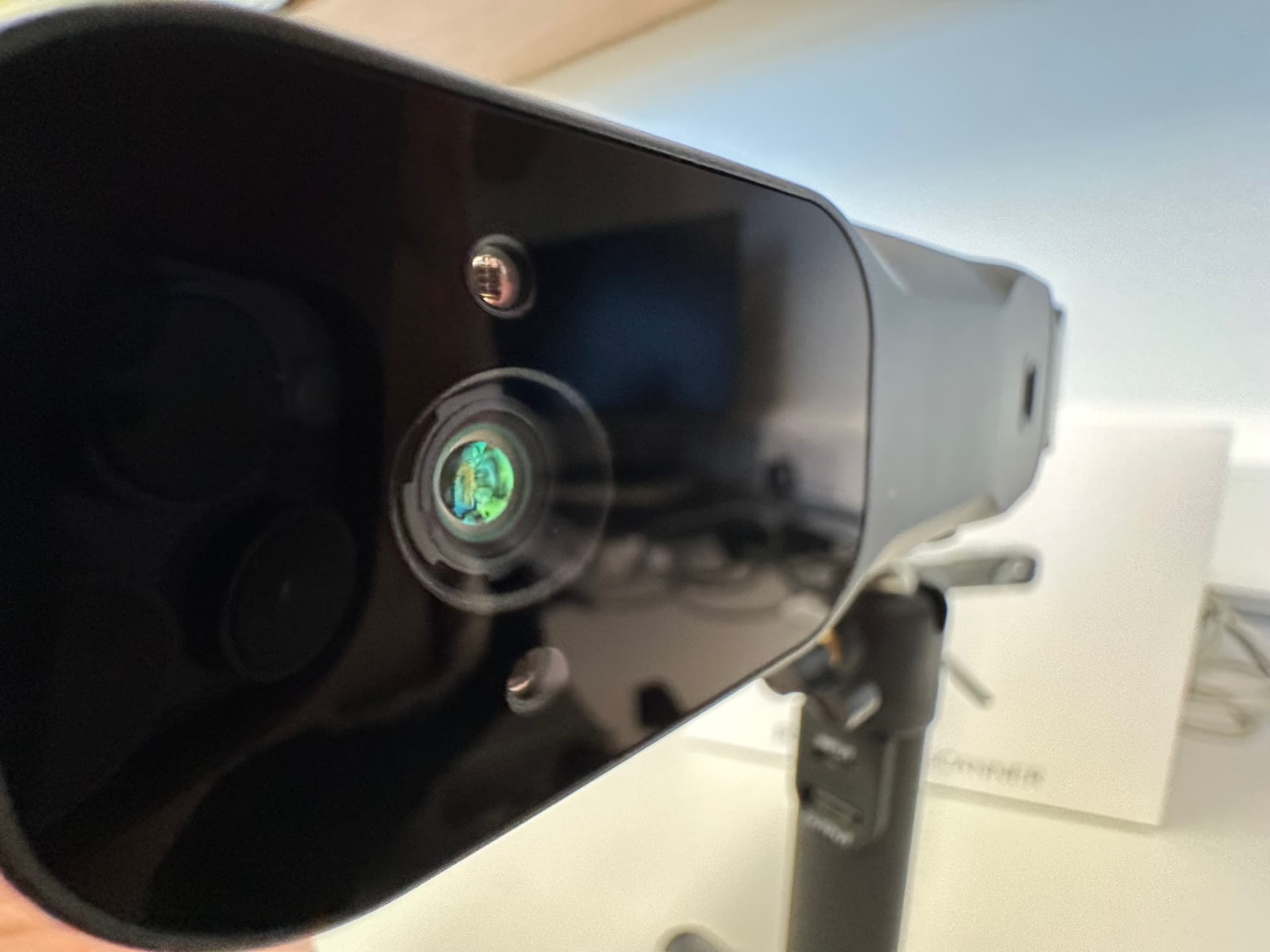

Range 2 is a handsome beast.
USB-C now. Excellent.
Nice big sensors and LEDs. Looks similar to Miraco’s far mode sensors.

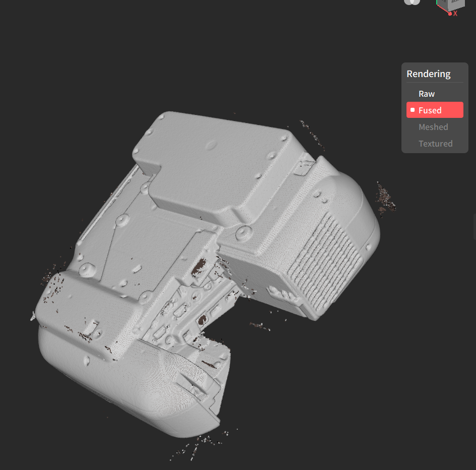

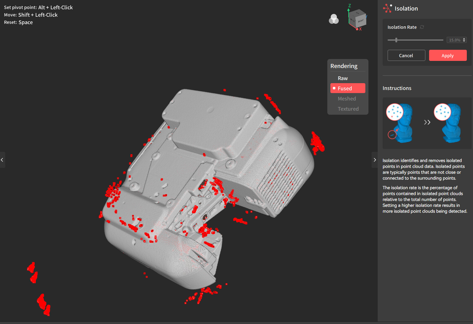

A large, ultra-short-throw projector
I had to use some spray on the emitter section because it was shiny black plastic.
Scanned in 2 orientations with the scanner hand-held.
Raw data
Fused without cleanup
Detect Isolated Points

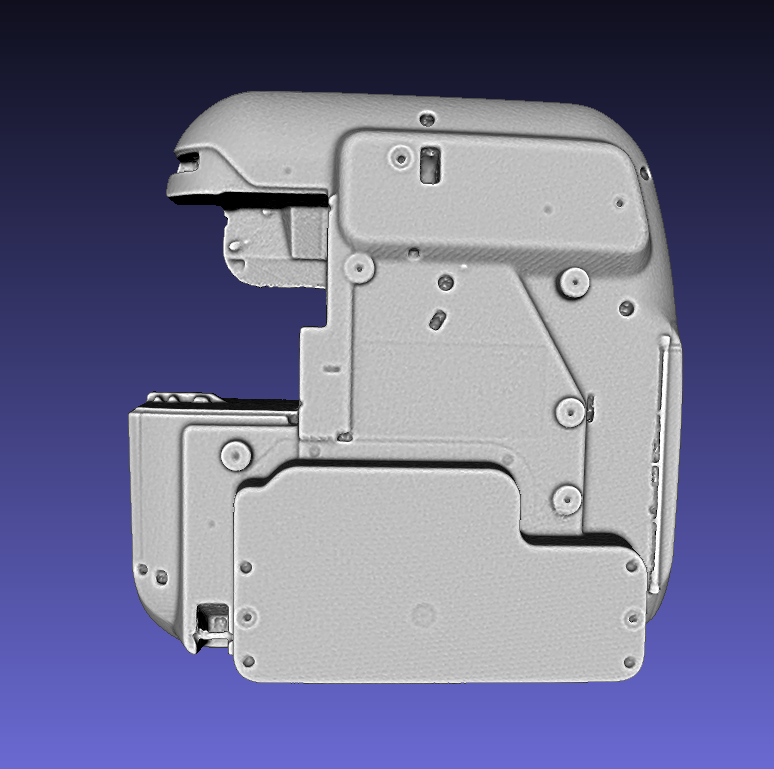

Mesh settings
Meshlab
Range 2 is just so easy to use. I defy anyone to not get good scans with it almost immediately.
