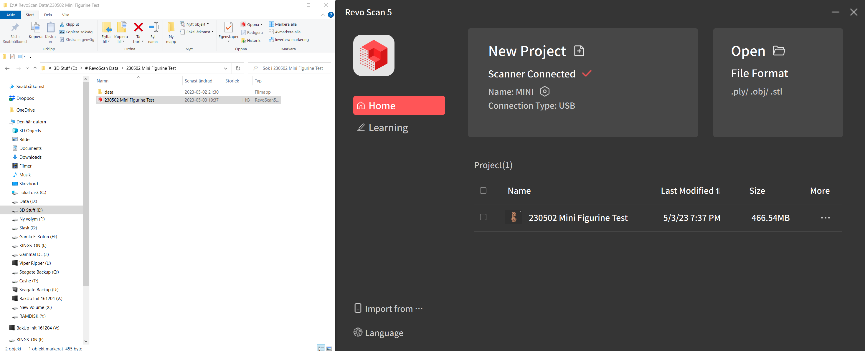

Thank you, that was not obvious, I did not turn every pebble to find the correct place =)

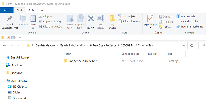

Interestingly the name is only changed in the application! the FILDER NAME stays the same?!?
Well well, for keeping track of my backup’s of scanned data I guess I will have to identify the project folder by means of opening the project folder.
Move one level up to access the project folder
Create a new folder on my BackUp drive named with the name I gave the project in RevoScan 5.
and finally copy the project folder to my named folder. This way I know which ScanData is What…
Nah, you don’t have to do that, just exit the program and rename the Project Folder AND the ‘.revo’
project file after saving the project and closing the application.
Start at new project then go to File → Load → Open a project and the change is done.
I guess the only thing they forgot was to actually rename the project folder and file when renaming the project within RevoScan 5 :slight_smile:
In short renaming everything is only good as long you see it open in the RS5 .
So don’t rename the individual scans inside your project as it will corrupts the project and you can’t switch between fuse and mesh if you want to edit it later again . The inside structure of the project should be not altered .
beside of the actual project name only as you did already .
