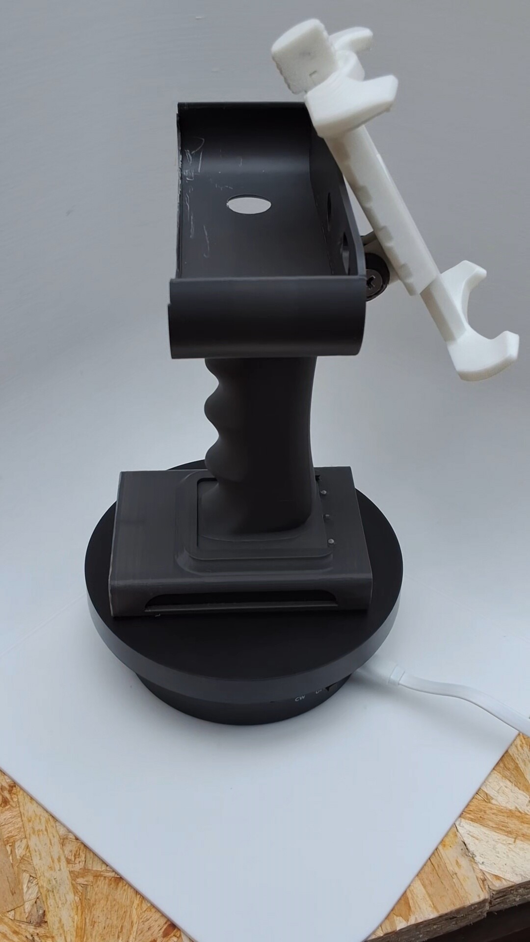

High everyone, I present my custom designed hand held unit for the Revopoint 3d scanner. This unit has provision for a battery to be used to power the Revopoint Inspire scanner. This allows the end user to use the Inspire 3d scanner via their smartphone through the scanner WIFI connection. Simply connect the battery to your Revopoint Inspire 3d scanner and switch to WIFI bridge mode and scan on the go.
Battery used in this design: 5,000mAh 2 Full Smartphone Charge Portable ECO Power Bank from Juice
1 No. M6 Nut and Bolts to secure the Phone Holder to the Unit.
The main cradle that olds the Inspire 3d scanner unit snaps permanently into the handle for a really strong and secure fit. The Inspire unit itself then snaps into the cradle securely for a snug and secure fit. Please see my assembly video below.
In the print profile I have Supports turned on with PETG as the interface layer. This ensures the overhang surfaces are acceptable, and thus does not create fitment issues.
