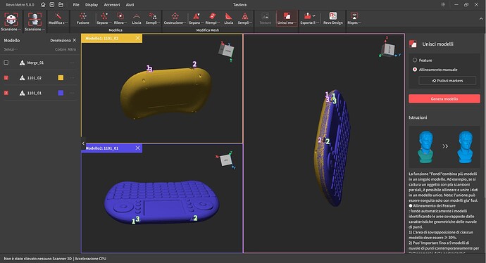

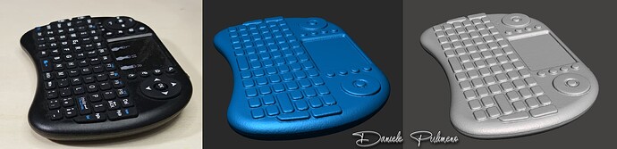

Mini Bluetooth Keyboard – 3D Scan with Revopoint Inspire2
3D scan of a fully black plastic keyboard made with the new Revopoint Inspire2, without any surface treatment or spray.
The scan was performed in Laser Mode, using Global Marker Tracking and the Black Object mode, specifically designed for dark surfaces.
The process was divided into two separate scans, rotating the object 180° to capture both opposite sides in full detail.
Once both point clouds were captured, they were merged at 0.15 mm, then cleaned to remove unnecessary parts and any isolated or overlapping points.
Before merging, the marginal areas — those less visible and not perfectly scanned — were trimmed out to avoid noise that could affect the model quality.
After cleaning, the two scans were successfully combined using the Merging function in Revo Metro, with no alignment issues.
Finally, the mesh was generated using a 0.15 mm grid with automatic hole filling.
The resulting model is perfectly aligned, with clear and well-defined details throughout.
The Laser Mode proved to work exceptionally well on black plastic objects — no surface treatment needed, and no tracking problems during the scan.
Really impressed by how Inspire2 handled this challenging surface.
