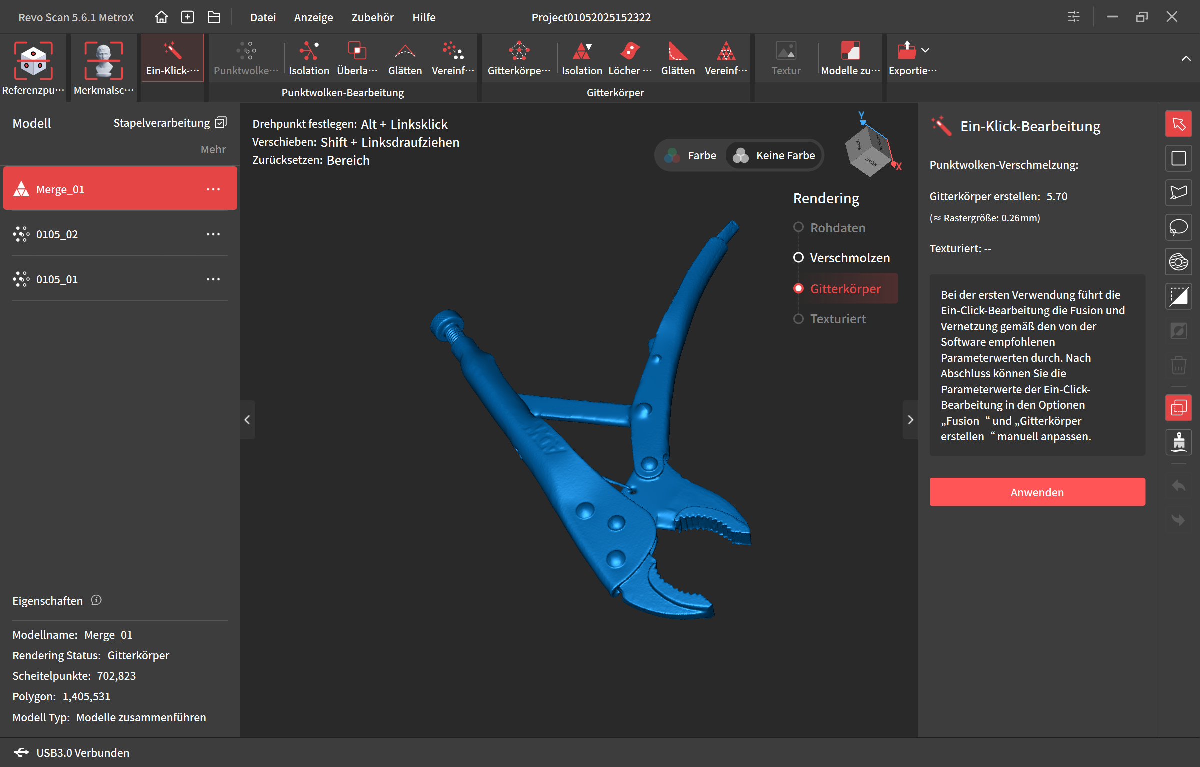

Proschi3d | MetroX |Schowcase
Hi @Proschi3D
Very nice scan !
What scan mode was this captured in? Auto turntable?
In Parallel mode
