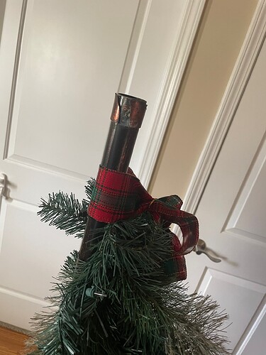

Last year one of our lamp posts got blown over and Broke the thin metal post mount.
Using our Pop 2 and some trial and error got a decent scan to model off of to make a split cap for a decent repair.

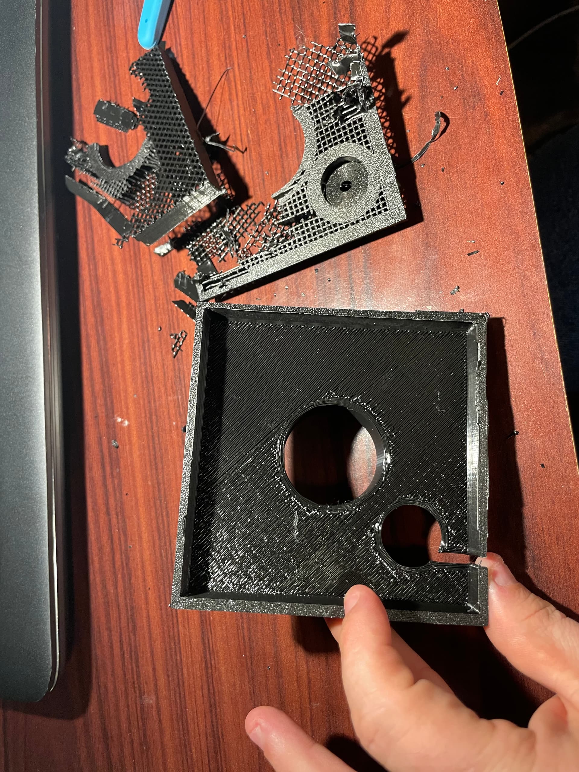

Next up Cura: (disclaimer I did clip the bottom for an even simpler cap, no other reason other than shorter print time just in case shrinkage bites me on fitment. )
Due to the cooler climate PLA+ was chosen from easy and quick test printโ€ฆ
Shrinken did make it a little tighter than planned but a little heat and super glue and sheโ€™s good as newโ€ฆ another decoration saved from the landfill.
If it breaks, another can be had in less than 3hrsโ€ฆ :slight_smile:
