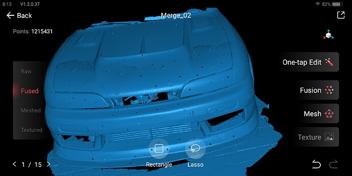

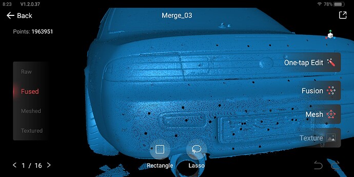

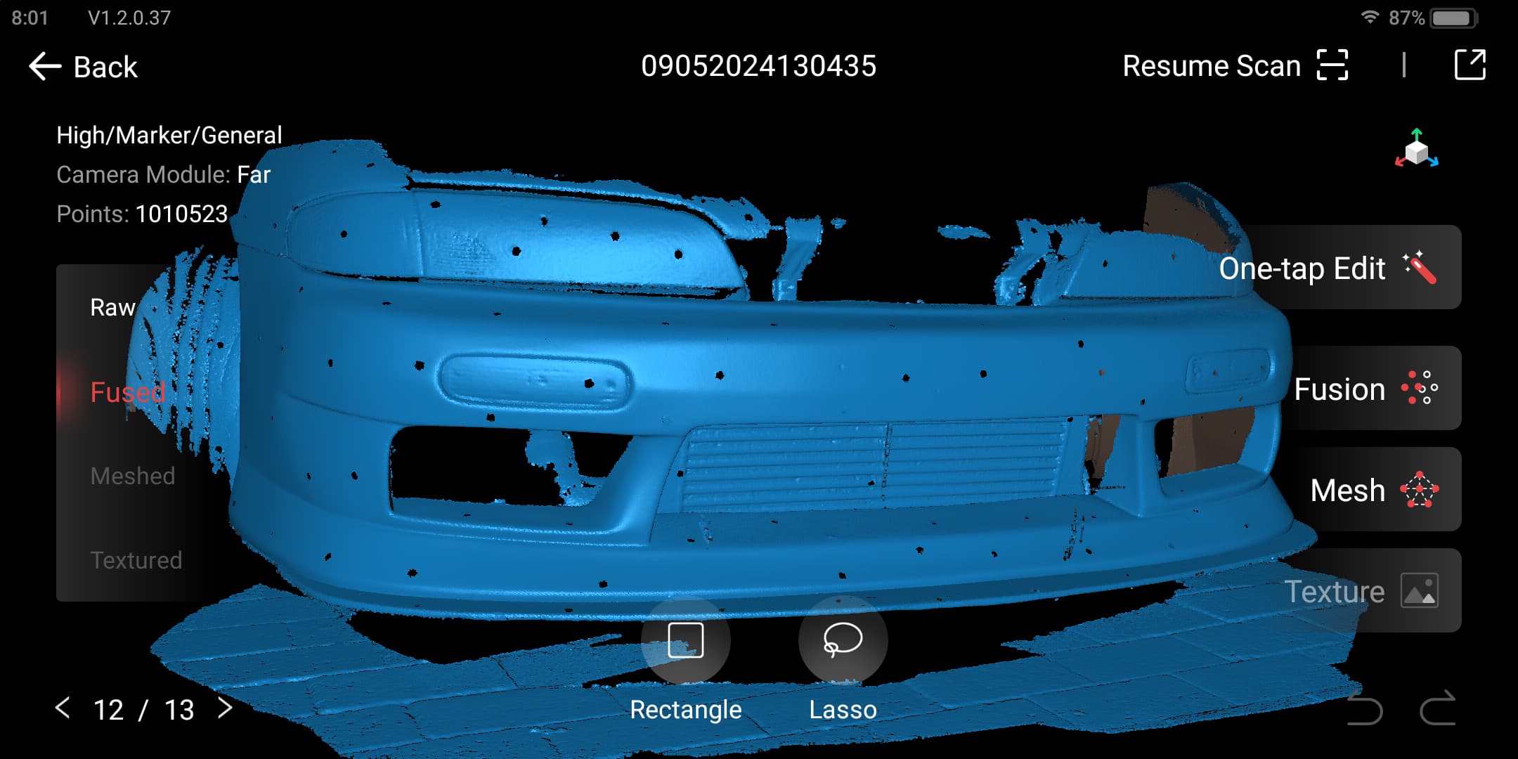

So far i did not have time to fully process the data yet, but I wanted to show some partial scans right from the miraco itself, some preview resolution screenshots:
Some aligned scans:
These will look pretty good once fused to high detail.
