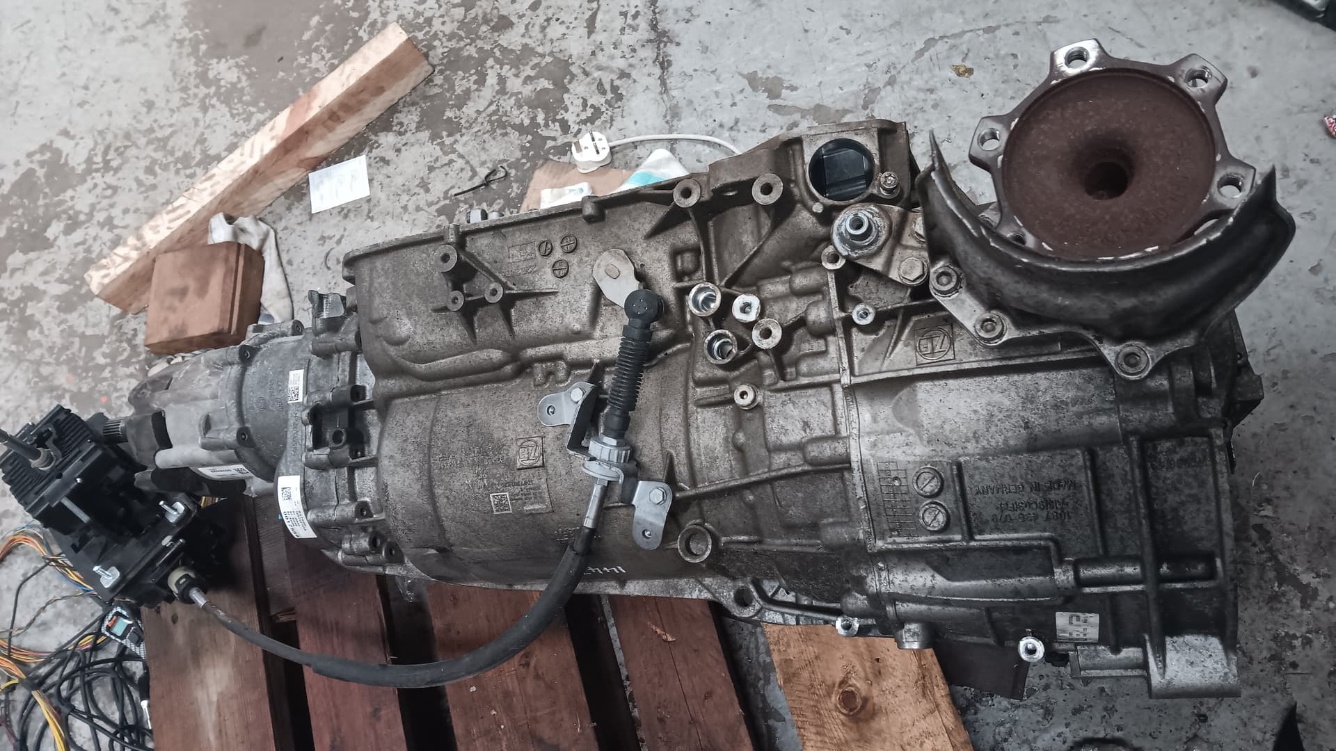

Been doing some gearbox controller development and gearbox adapter plates so thought I would share some of the scans I’ve been doing along the way
Audi 4X4 ZF8HP55 gearbox
Lovely work Johnathan!
ZF8HP50 scan to get bell housing dimensions
ford auto gearbox scan to get engine bolt pattern
both scans aligned to do the adapter CAD
3D print to test fit the new ZF8HP50 onto the V6 Cosworth engine
CNC cut alloy adapter plate fitted
Flex plate adaptor
Gearbox in the car ready for the electronics and testing

Yes that’s on the jobs list to do, I need to cut some of the dashboard so the display will stand up a little more, its a 10.1" display, I could have used a 7" display that wouldn’t have needed any cutting of the dash but i like the bigger 10.1",
I’ve programmed the gearbox controller and display so all the gearbox settings can be adjusted through the touch screen display,
When I’ve cut the dashboard I’ll scan it and 3d print a new pice to fit the screen and finish it off nicely
