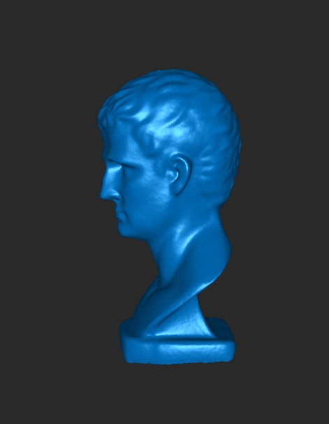

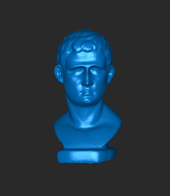

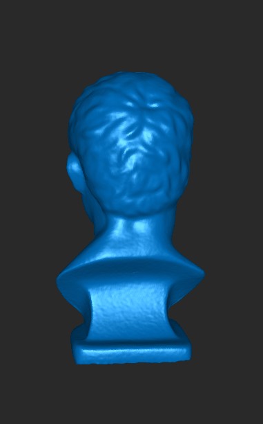

I scanned the bust of a statue outdoors at an illuminance of 23,000 lx (measured with a digital lux meter at the subject).
Setup
  • Weather: clear sky, subject in shade
  • Scanner: Revopoint INSPIRE 2 with outdoor filters
  • Mode: Outdoor
  • Smartphone: Samsung Galaxy S23 Ultra
Acquisition (Video speed: 4X)
Mesh: reconstructed on PC with Revo Metro 5.8.4
At 23,000 lx, the INSPIRE 2 (filters + Outdoor mode) performs well. It confirms excellent performance both indoors and outdoors.:heart_eyes:
