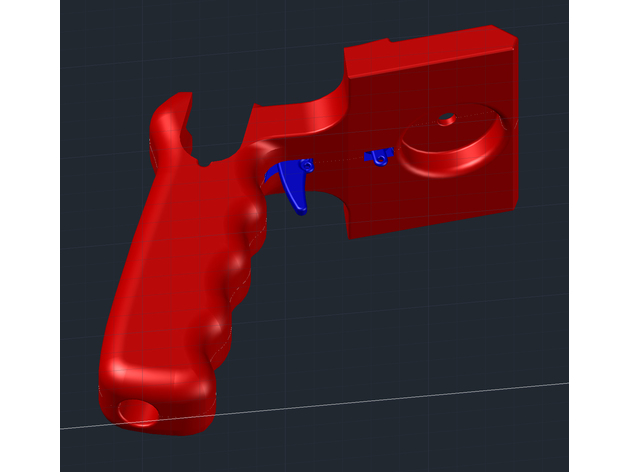

I have updated my project of design a handle for REVOPOINT POP & POP 2 3D with a mobile phone and the original powerbank included in the Premium Kit turning it to an autonomous set to scan more comfortably.
The link of thingiverse: Handle to be used with REVOPOINT POP & POP2 3D scanner by JJCHACON - Thingiverse
This project is still a Work-In-Progress… Now I have developed the 2nd version and its very functional… its near to be finished.
If somebody wanna suggest ideas or modifications may tell me replying this message.
Impressive design. I expect the cable guides are very useful.
You said this is a work in progress, so are you going to add a trigger assembly to work the Start/Pause button?

The implementation of a mechanism to actuate over play/pause button is an interesting idea.
I will study it and try to do.

Be sure to put the axle close to the button and brace against the front of the POP’s case (that button likes a firm press).
OK… I will keep it in mind…
Yo can see the new work in progress of a new geometry handle with shutter in the link:
