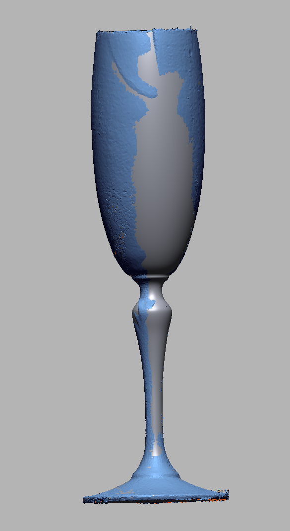

3D-scanning a glass!
This glass was broken, i glued the parts together and made a scan of it.
Afterwards, i reversed a model in CAD.
This scan i made in global marker mode. I made a scan from one side only, because i was needed to get only a sketch for CAD.
As you can see, the cracks are clearly visible on a 3d-scan!
