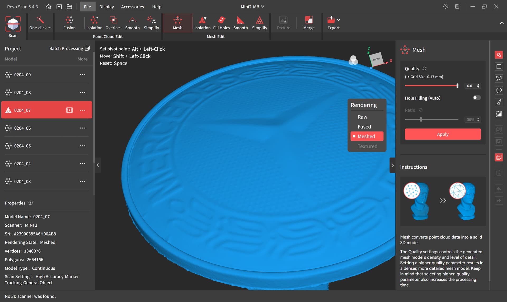

2. Results
Mini1 details:
Mini 2 details:
3. Conclusion
As you can see, mini 2 captured a little bit more details. But why?
Suppose that the reason is a scanning distance.
I found, that Mini 1 scan is very good at 120-130mm, but at the same time, mini 2 is able to get perfect details at 175-185mm distance!
What does it mean? It means, that you get more markers and features in field of view with mini 2 than with mini 1.
Because of that you will get different workflow with mini 1 and mini 2. You need to get closer with mini 1. On my opinion, it is a little bit harder to scan at closer distance. But if you go further, you will lose some details.
Here is the answer, why i got better details with mini 2.
I scanned the same model, but when i scan it with mini 2 it was a comfortable 180mm distance. But when i scan it with mini 1 i used 165mm distance and lose some details.
Here is the benefit of Mini 2 - you could reach the same amount of details at longer distances.
