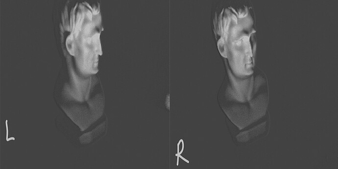

There is also an interesting… quirk… of the hardware. There are two sensors, one on each side of the emitter.
When you have something ready to be scanned, cover each of the depth image sensors one at a time. The results are not what you’d expect (certainly not what I expected).
Still, it works.
Yes Jeff that is true , the difference are huge , I was thinking there is less
that is actually how the left and right Depth sensors sees …

Hi Bruce , it was a pure accident , I opened my video editing program while POP2 was on , and it was thinking the webcam is connected showing the image , however it was in color , green for the background ( dark areas) and pink shades for the object .
