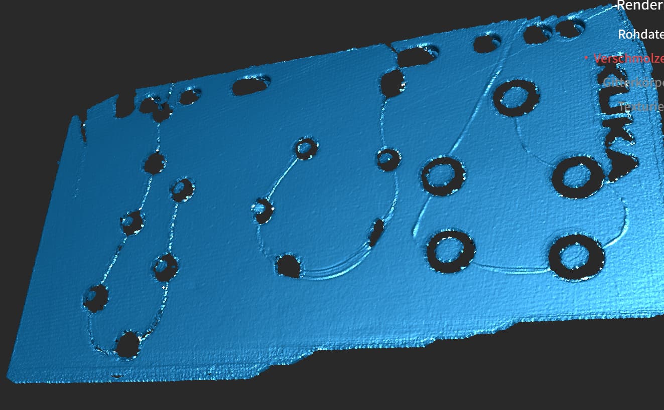

Here are the Results for 0.1mm Nylon Black, the nylon is very stiff, you can also see how it sticks out
so far i would prefer cotton, it is more visible but softer, the dots lay down better, especially on long smooth surfaces, which makes it very useful. But I will continue to experiment.

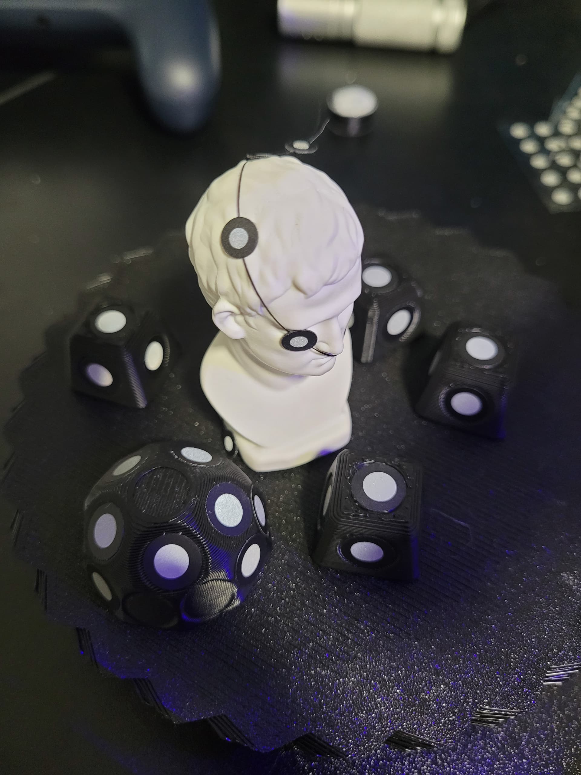

Small update here. I received the 0.5mm nylon cord. It’s actually a fishing line from Japan, and it’s very affordable and transparent. So far, I found it to be the best, as the nylon is not too rigid and leaves few marks on the scan.
The nylon thread I used before (1mm black), was too stiff.
With the cotton thread, the issue was that the scan had a lot of noise.
Don’t be surprised that I used the large markers with the new nylon thread. Unfortunately, I no longer have the small ones.
but it still capturable, difficult to cleanup afterwards
You can mark the line, delete it and fill it. I think it is very well suited for reverse engineering due to its application.
I also have to say that I only ran my hand over it once, if you scan from multiple sides you might also capture the bottom part.
Just remove it with the tool and use close hole function , it should do the trick .
