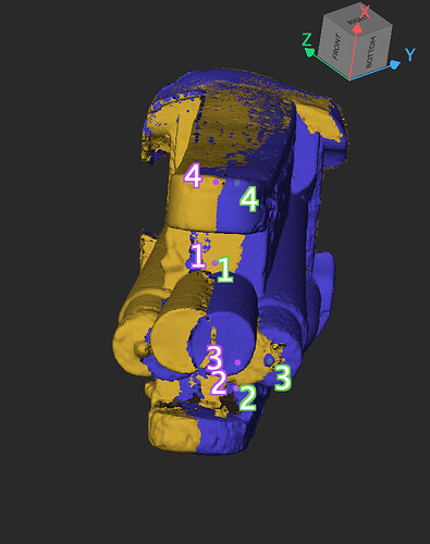

What am I doing wrong? Merge doesn't align
See attached image. Even manually selecting markers, they don’t actual align themselves - they’re offset. 1 on the one model doesn’t go where 1 is on the other model.
Clearly offset on the merged model, despite them not be when I manually do them on each model.

Point 4 seems off.

4 Points chosen, on 4 different faces as such. So plenty of distance between them. Exactly the same results.
Swapping them around and spending 10 minutes choosing different markers has had some success, not perfect but closer. Gives me some hope, although frustrating…
