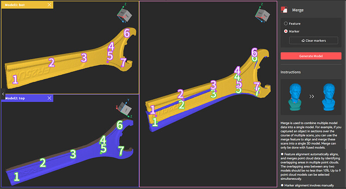

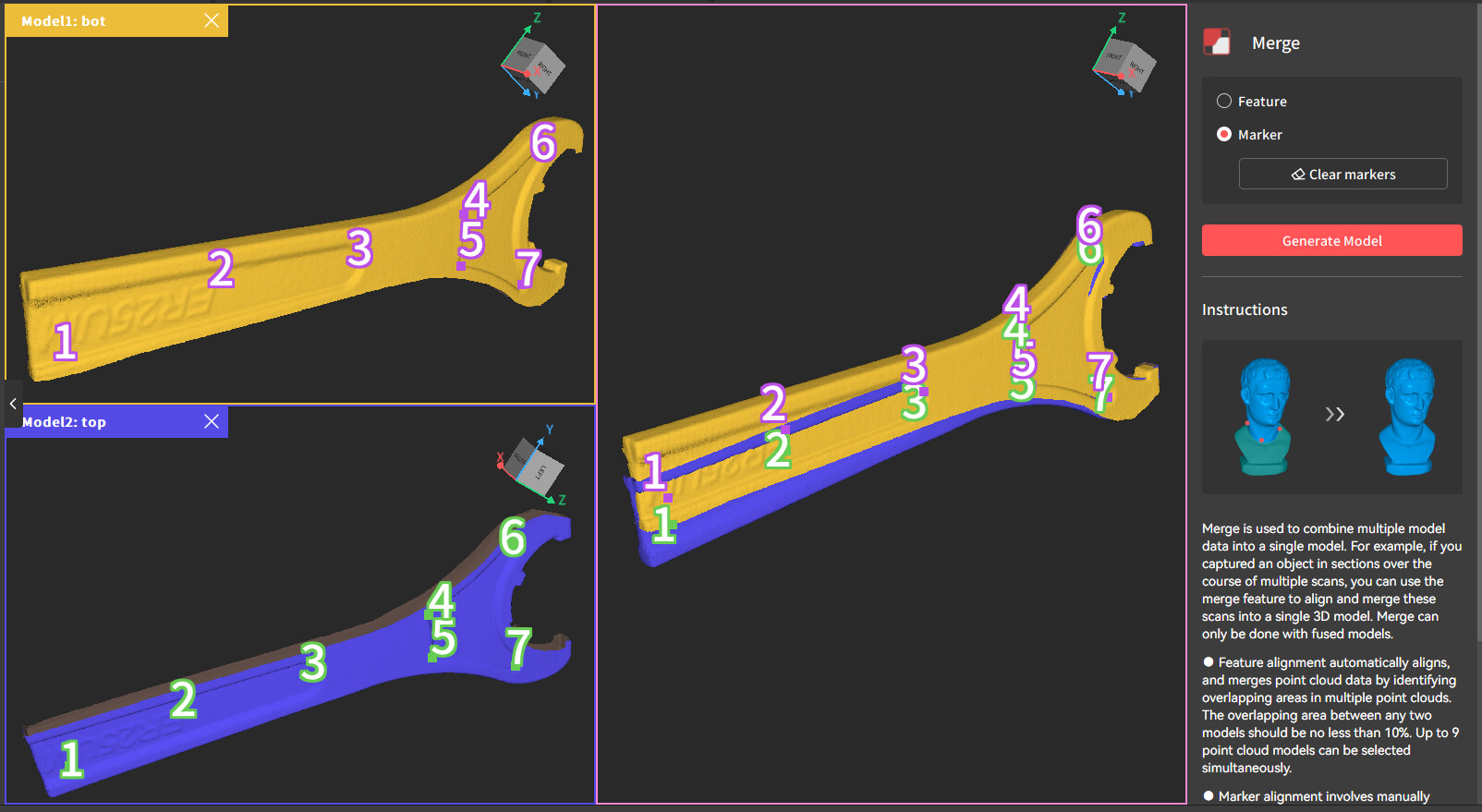

Just tried to merge the scans of a wrench using the marker method. Don’t expect any good results because there is not much overlapping between the two scans. The surprise is that the software does not even line up the markers correctly as seen in the picture. Need some helps here.

The marker locations are not accurate for sure but its not random either. In all the videos on marker-based merging I have come across. The markers are placed on rather fussy features that do not precisely define a point nor the operator tried to zoom in to place the markers more accurately. As said in the post I did not expect very good alignment in this case but the software putting different markers at the same position is kind of puzzling.

Looks for all the world like it ignored the markers and did feature alignment.
Pure speculation on my part, but if the markers really don’t define a feature that’s useful perhaps it reverts to feature merging. I’ve noticed on scans with symmetrical features it loves to flip them 180 degrees even if they start in nearly in alignment.
That why you have manual marker mode to avoid flipping , still you need to find features on the object the whole point of registrations no matter what software you use . Of course other programs like Cloud Compare have advanced registration process beside the simple aligment what improve everything so much better .
That’s. not what happen as it is impossible , it simply did not found matching points suggested by the user and could not register it , in short the points was in wrong location what resulted in error .Normal behavior .

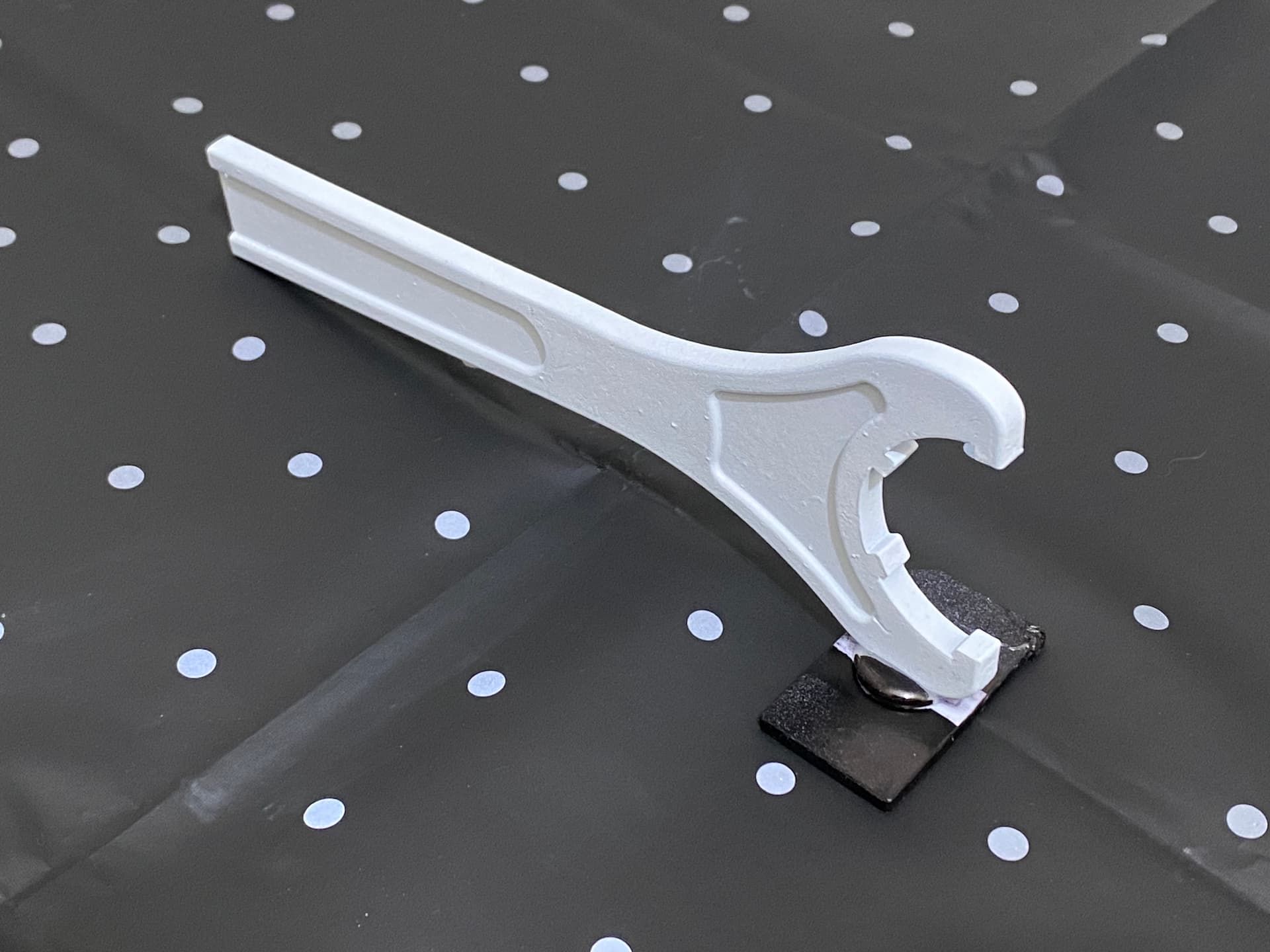

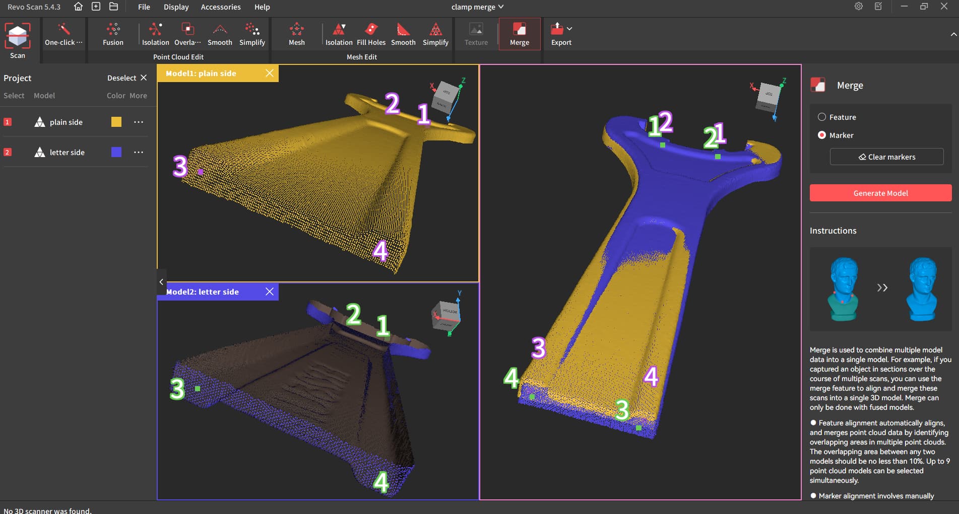

I tried again by scanning the wrench standing on each side followed by merging the two scans using the marker method. The result is not that good. Perhaps it is due to the fact that the features on the wrench is not too prominent or they are too symmetrical for the merging algorithm to distinguish the two sides.
Can you send me the project file zipped to putvmail@gmail.com or the 2 pointclouds zipped ?
project file just sent
