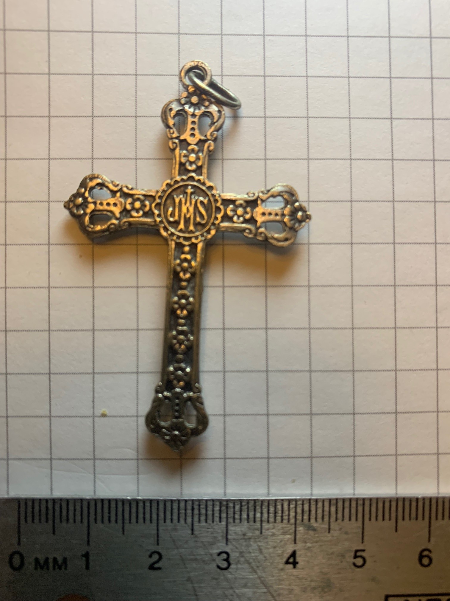

I am about to order a MINI, but would like to know it will accomplish my goals. I recreate religious medals and crucifixes that are old world. They have a lot of detail. My plan is to scan, 3D print in castable resin and cast copies. Can someone post a sample scan of a detailed crucifix about 2 inches tall that has an ornate background so I can see level of detail? I sure don’t want to have to buy a $6,000 jewelry scanner.
Any help appreciated. I could also snail mail a sample to scan to anyone in the US who is willing.

Not sure if these will show. Samples attached.
Thanks for replies to date.
My printer resolution is 45 micron xy and 10 micron layer so I am assuming printing the scans will work.
PS: I have jewelers mica powder I can apply if needed due to reflection.
Hi John , yes it will works without issue , the scan resolution is 20 microns as long you keep the distance at 10cm between the object and the scanner , it will be easy job to scan the relief.
