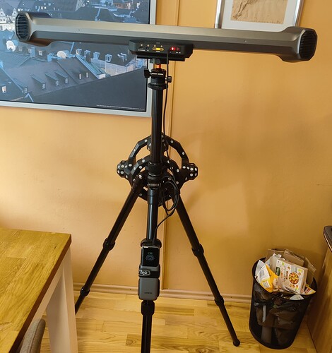

Usage:
This mount is designed for the UGREEN Nexode 25,000mAh Powerbank.
The Trackit needs 12V and consumes while normal scanning usage roughly 25W and therefore an Powerbank or Power-Brick with 12V 3A output is sufficient. To get the 12V output from USB-C to barrel-jack such a cable can be used: https://de.aliexpress.com/item/1005006058252700.html?spm=a2g0o.order_list.order_list_main.24.51d91802JtIChz&gatewayAdapt=glo2deuhttps://de.aliexpress.com/item/1005006058252700.html?spm=a2g0o.order_list.order_list_main.24.51d91802JtIChz&gatewayAdapt=glo2deu (12V version needed!)
Beware: While performing calibration with the dual-axis gimbals the scanner consumes up to 60W. Original powersupply is used for this.
Mounting:
The mount is secured to the tripod with 4 zip-ties and the powerbank can easily fixed with a velcro-strip. I used a velcro from my FPV-drone but other 20mm wide ones are suitable.
Even with the mount attached you can still close the case containing tracker and tripod (was a hard-requirement), to improve the fit simply swap places with the tripod used in calibration.
Printing:
Best printed from TPU for imroved friction and protection, other materials should also be suitable (small double-sided tape may be needed to prevent slipping between mount and tracker).
