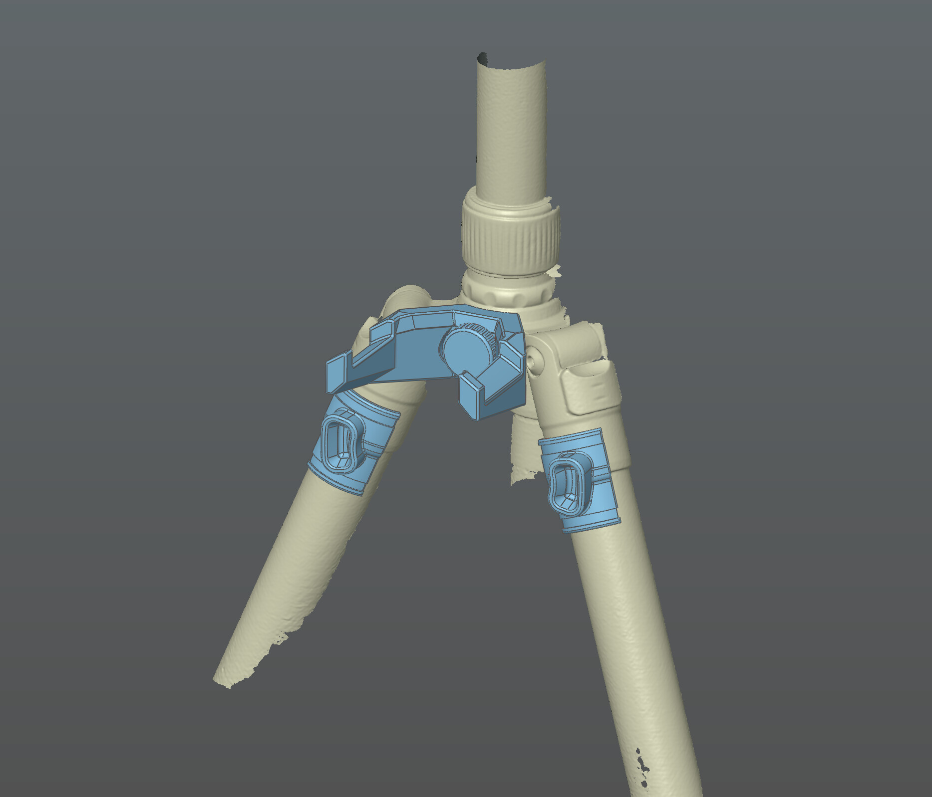

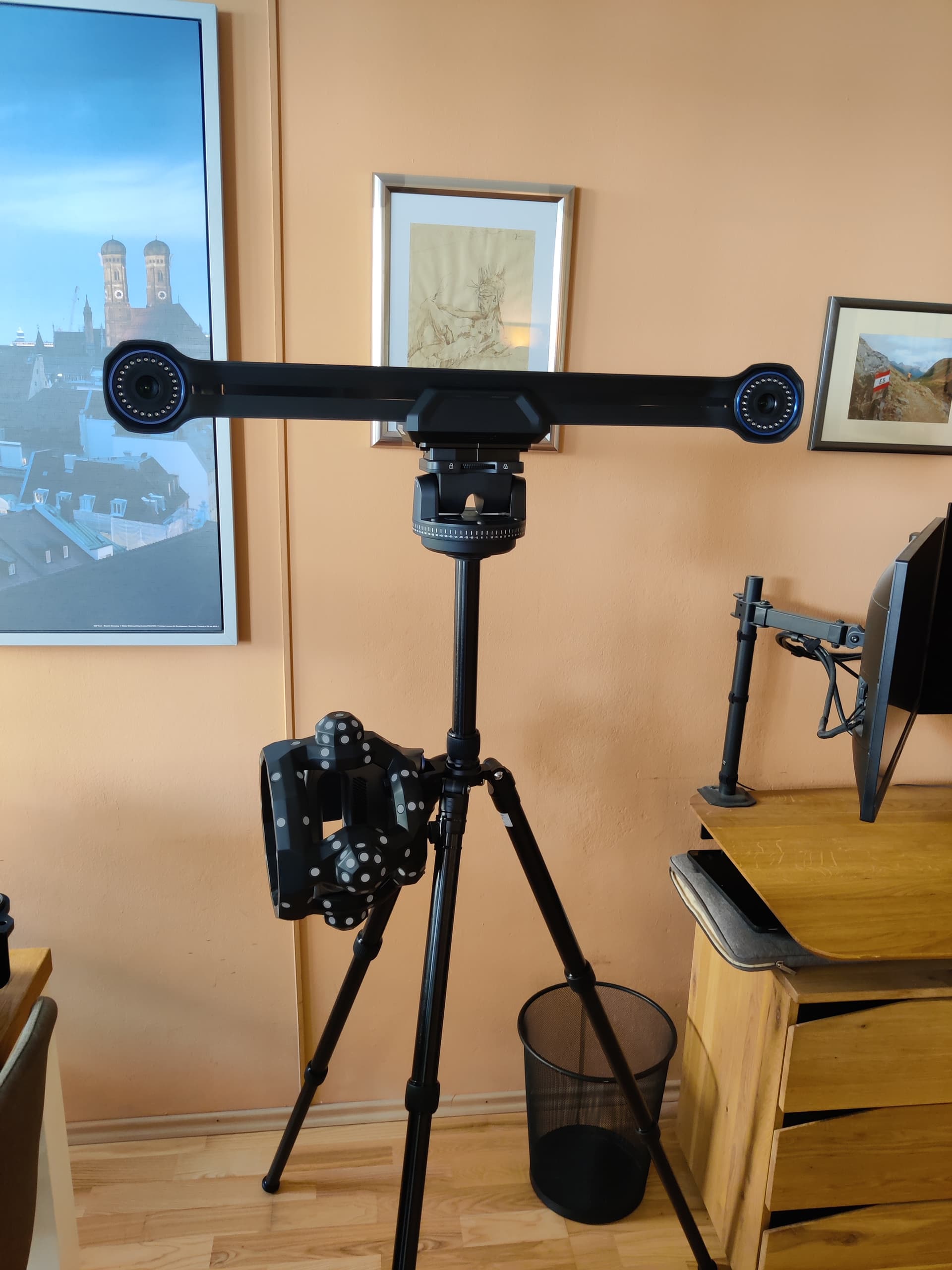

Designed this hanger for the scanner of the Trackit.
Wanted to be able to “park” the scanner in between scans and making moving the Trackit around easier.
Here you can find the model and step files for the hanger: https://www.printables.com/…/1407976-hanger-for…
And here is the scan of the Trackit I used for designing: https://www.printables.com/…/1407719-revopoint-trackit…

Updated version:
Very nice job on this one Philipp, thanks for sharing !

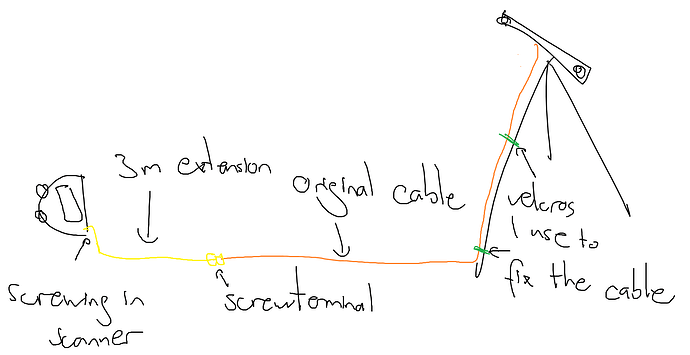

In the best case an extension would look like this. Since the stock cable is already an active one I guess it should handle an additional 2-3m without any problems.
I will test the shorter and longer one I have to see any difference in performance .
The way you portrait it is exactly how I would do it.
