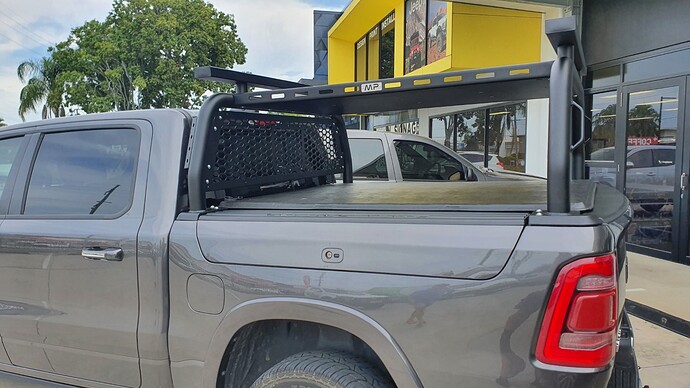

We scanned the tub of a DT Ram 1500 using the Revopoint POP2 to capture anchor point locations for a perfect fit of Murchison Products’ Adventure Rack.
From the scan data, we designed the machined alloy footing brackets—engineered to bolt straight on with precision. The best part? They match the tub’s styling so well, it looks factory fit 👌
Another early Revopoint product that is still proving to be effective. We did this in several scans using “Feature Mode” and merged them together.
To help with tracking, some Hex Bolts were placed on the “Ram Box” trim piece, as you can see, lol.
