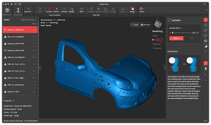

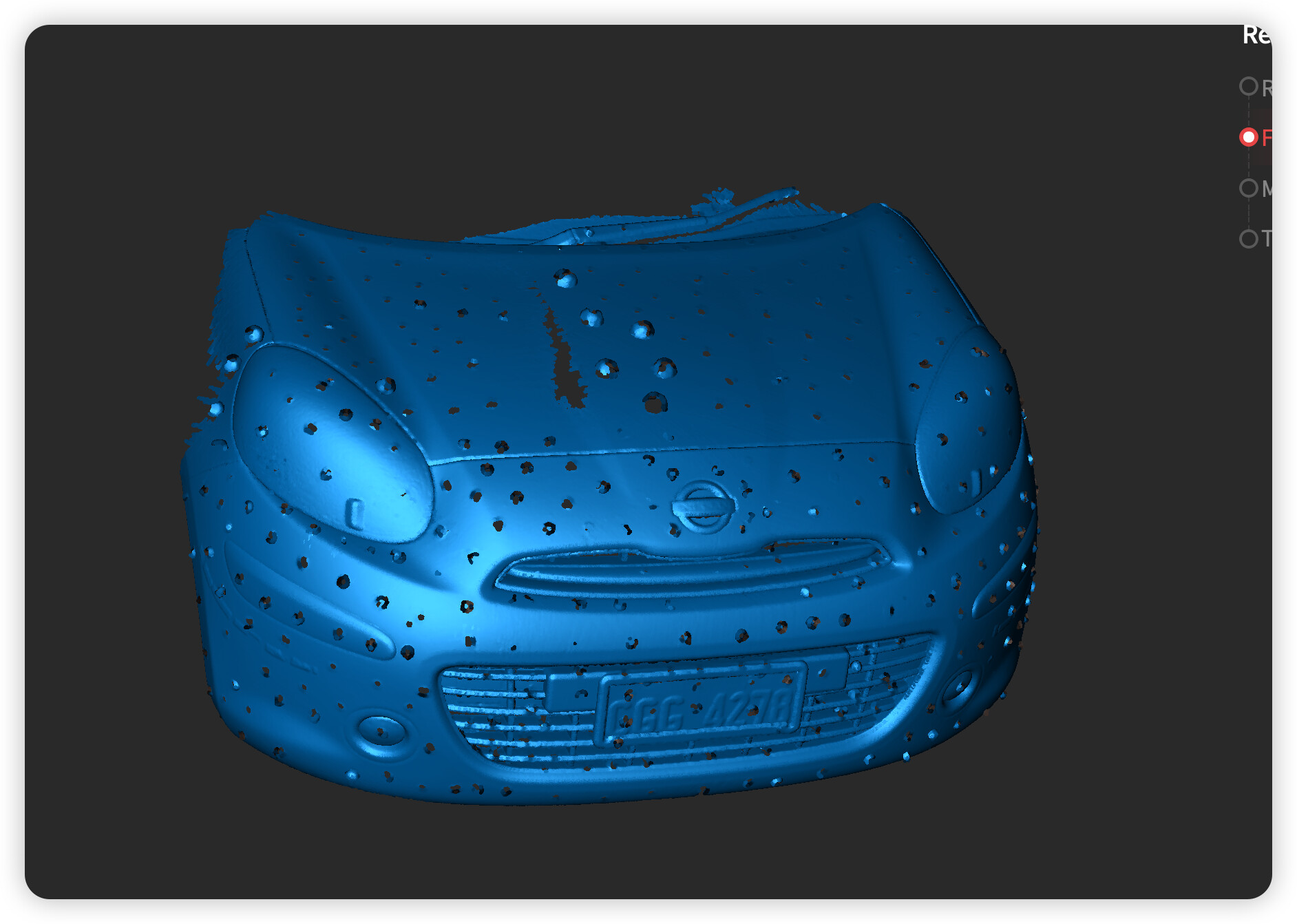

After switching to the DIY magnetic marker setup, I’ve experienced a significant improvement in both efficiency and workflow compared to the traditional method of placing marker blocks directly on the scanning surface.
Previously, even with the “Remove Markers” option enabled during post-processing, I still needed to manually clean up leftover marker geometry, which added complexity and time to the workflow. On average, this added at least 1 hour to the post-processing phase.
With the magnetic marker method, the workflow is greatly streamlined. After scanning, I proceed to the Fusion step, enable Remove Markers, and set the hole size to 10mm to match the punched markers. Then I continue with Mesh Generation (without fill hole), followed by manually filling the holes using the Curve option, depending on the scanned object’s geometry. This method eliminates the need for manual cleanup, saving considerable time.
