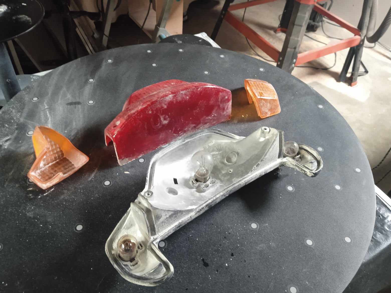

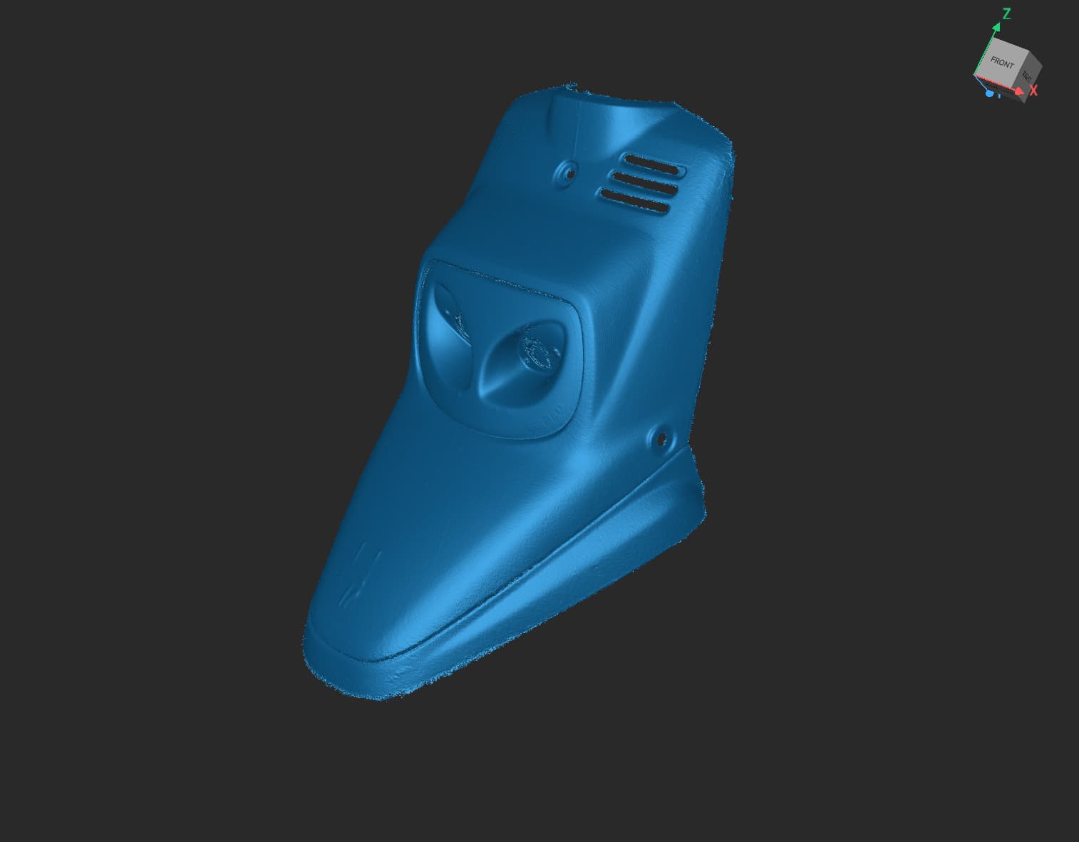

Hi, I am presenting my project, I want to make a 1/5 scale scooter.
I scanned all the pieces with the miraco.
I started with the frame, which wasn’t easy, I did them in single shoot
here is the resin rendering
Small view of blender to see the size
