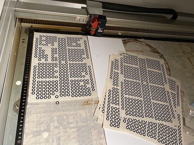

Wonder if I could cut these with my new laser cutter/engraver…Might be fun to try! Just use a blank sticker sheet…have to change it to our weird american system but that would be fine…

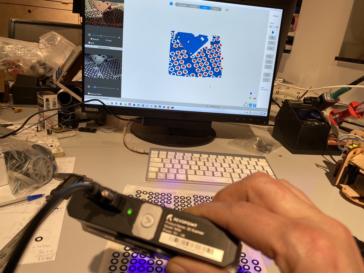

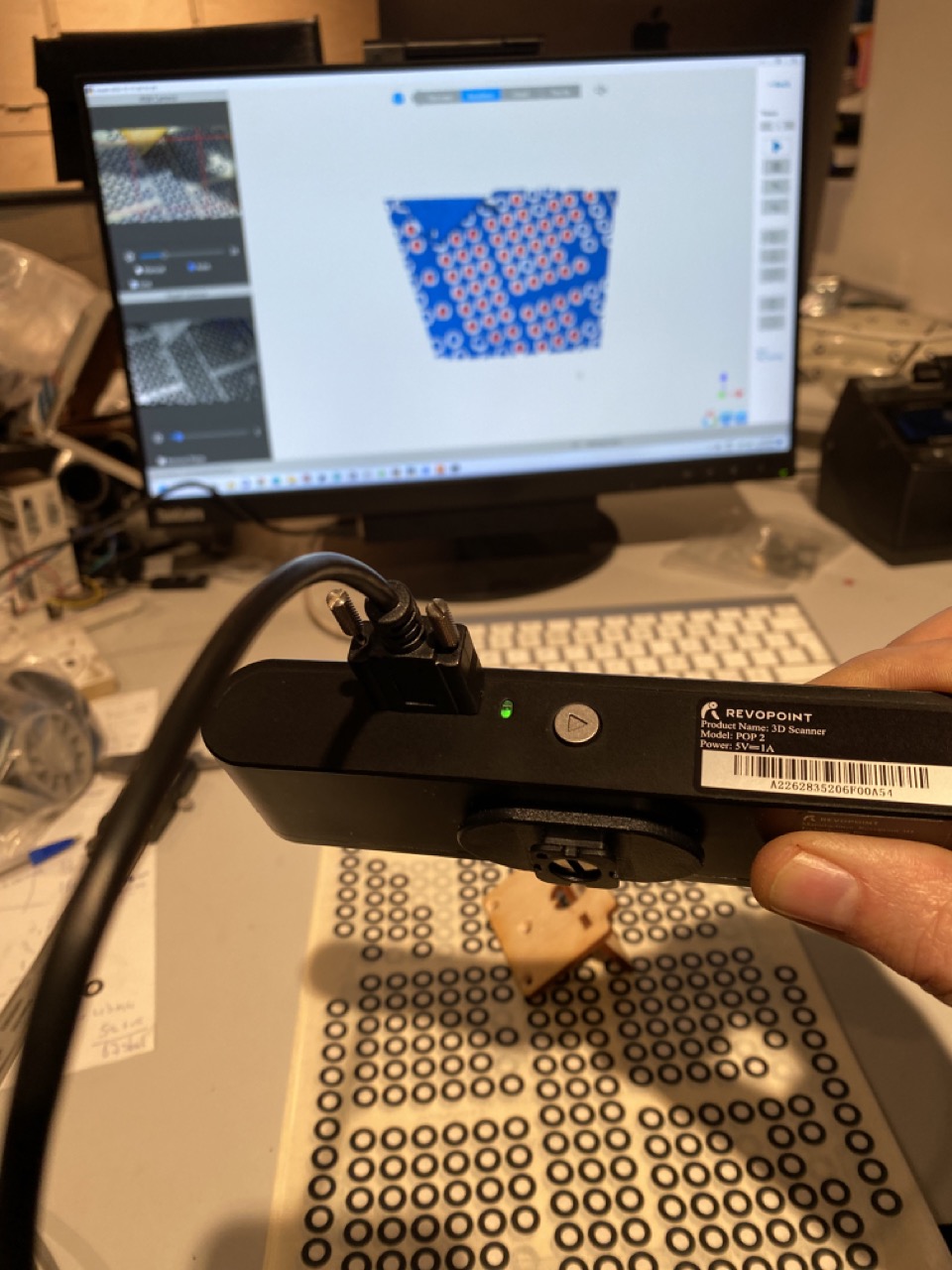

Unfortunately, this doesn’t work for me - neither with the Mini nor the Pop 2. Markers are not recognised - perhaps due to using an inkjet printer (3rd party ink Brother JW series)? Do you guys use lasers?
It have , because inject print is visible to Infrared laser and laser reflect it .
Same as black cotton (visible) vs black nylon ( invisible) for markers to work correctly the white dots need to be separate from the surface , so black inject printing can’t do that .
Thanks for the update … in fact I have been using the markers on the Mini only so far … but with migrating to the POP2 I will have to check if marker printed with a laser printer will work for me …
That’s not exactly how it works .
The white dot need to be separate from the background to be recognized as a marker .
This mean the if you used yellow stroke for your MINI markers it would works too because MINI blue light is absorbed by yellow .
For POP2 use only backgrounds for the dots that are invisible .
For example you can throw some rice on a black plastic plate or plastic bag and it will be recognized as a markers …
So don’t think it needs to be exactly what they tell you it have to be .
It is not about the black color … it is about the property of the surface .
The point is to separate the white dot from the rest of your scanned object surface so the software can recognize it as a marker .

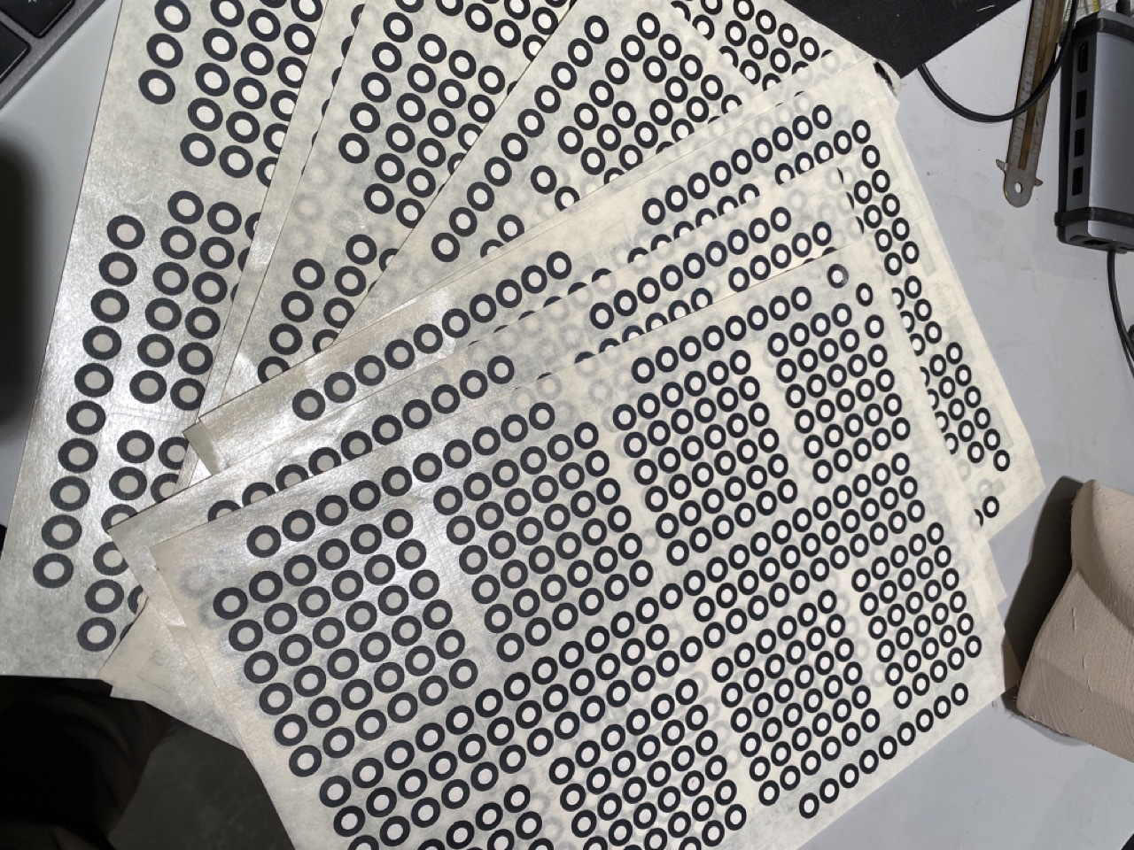

Yes, I could
Laser scouring these sheets takes 2,5 minute per sheet, not really production numbers.
But for larger production numbers there are more cost efficiënt ways.
The test I did is more for people with acces to a laser cutter.
