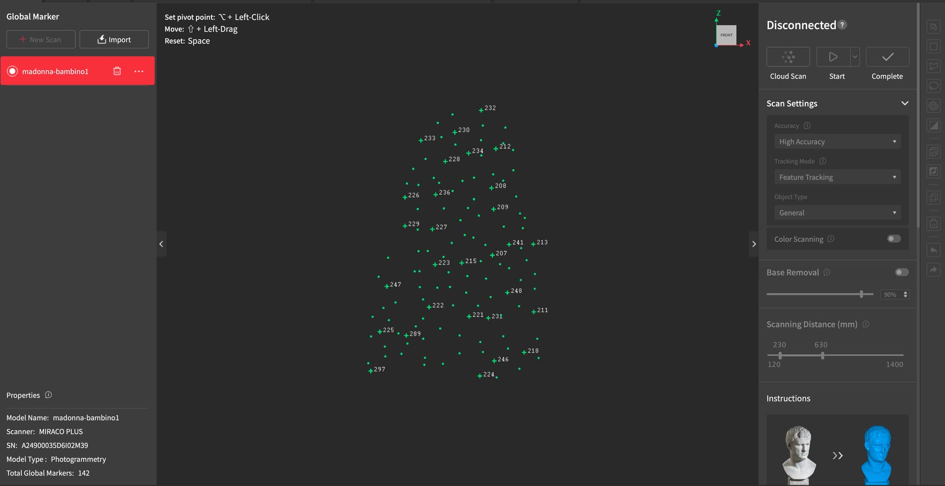

The first “challenge” consisted in positioning the targets, markers and bars of the PMK kit on the surface of the work (but I succeeded).
The markers and targets, which are adhesive, could be easily attached (and subsequently removed without damaging the original surface).
The two bars were more complicated to keep in place, but with the help of a double-sided gel tape it was possible to keep them in place (for the entire scanning session) and they too were removed once the scan was completed, leaving the surface untouched.
Once the sculpture preparation was finished, I proceeded with the photogrammetric acquisition session, following the instructions in the user manual, taking 60 photos, and using the angles suggested in the tutorials.
We then proceeded with the processing and in the end here is the result:
Next, after removing the two bars, once the global marker reference was loaded, I proceeded to scan, using single shot mode.
Subsequently, once the global marker reference was loaded, I proceeded to perform the scan, using the single shot mode (410 frames):

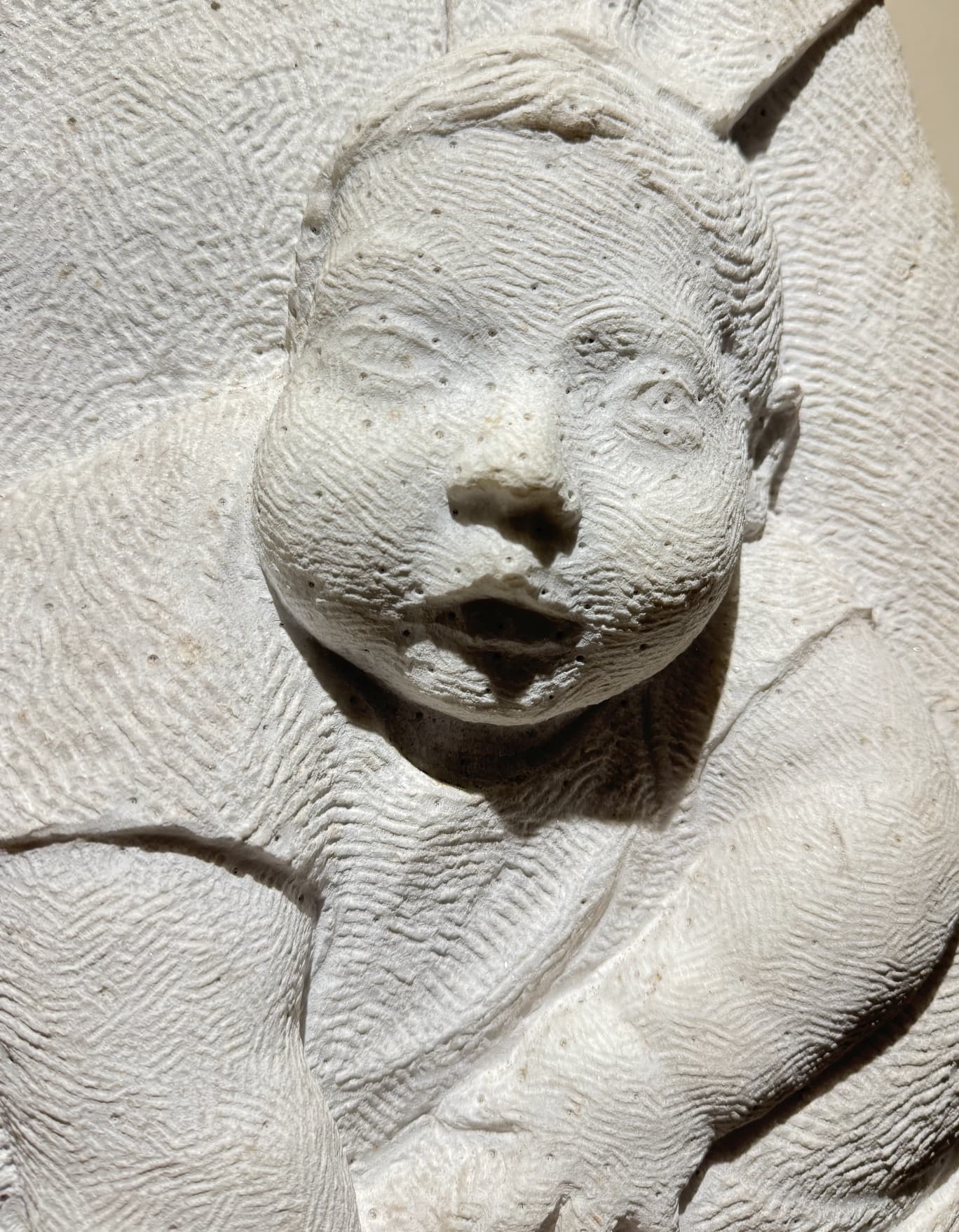

The result is remarkable, the chisel work (made with a special chisel with teeth called “gradina”)
(image below, indicated with yellow arrows) of the surface is clearly visible as well as the measuring points (red arrows) used by the sculptor as dimensional references (Pointing machine - Wikipedia).

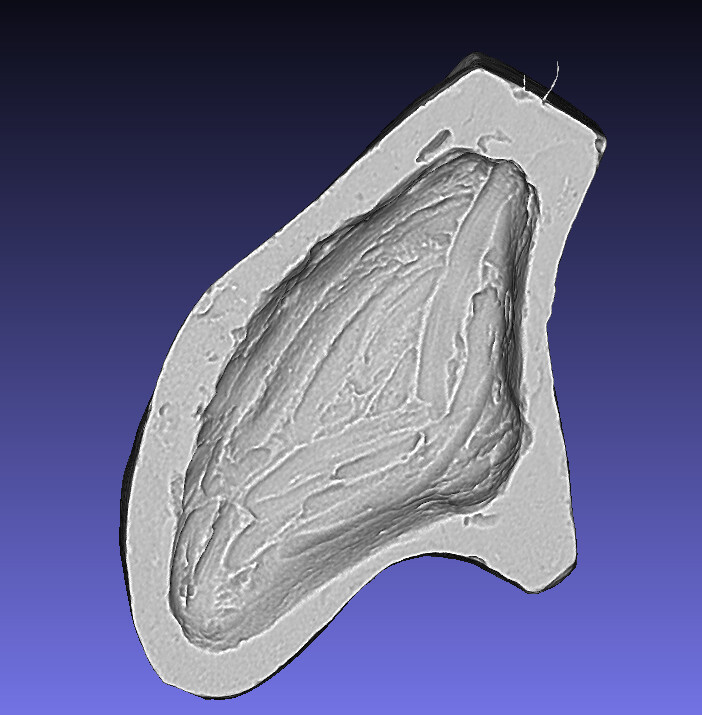

An anatomical plaster model of a hand
Scan made in single shot mode (173 frames)
All edited in Revoscan
Raw
Fused
Meshed
Size in Meshmixer
“Meshlab”
