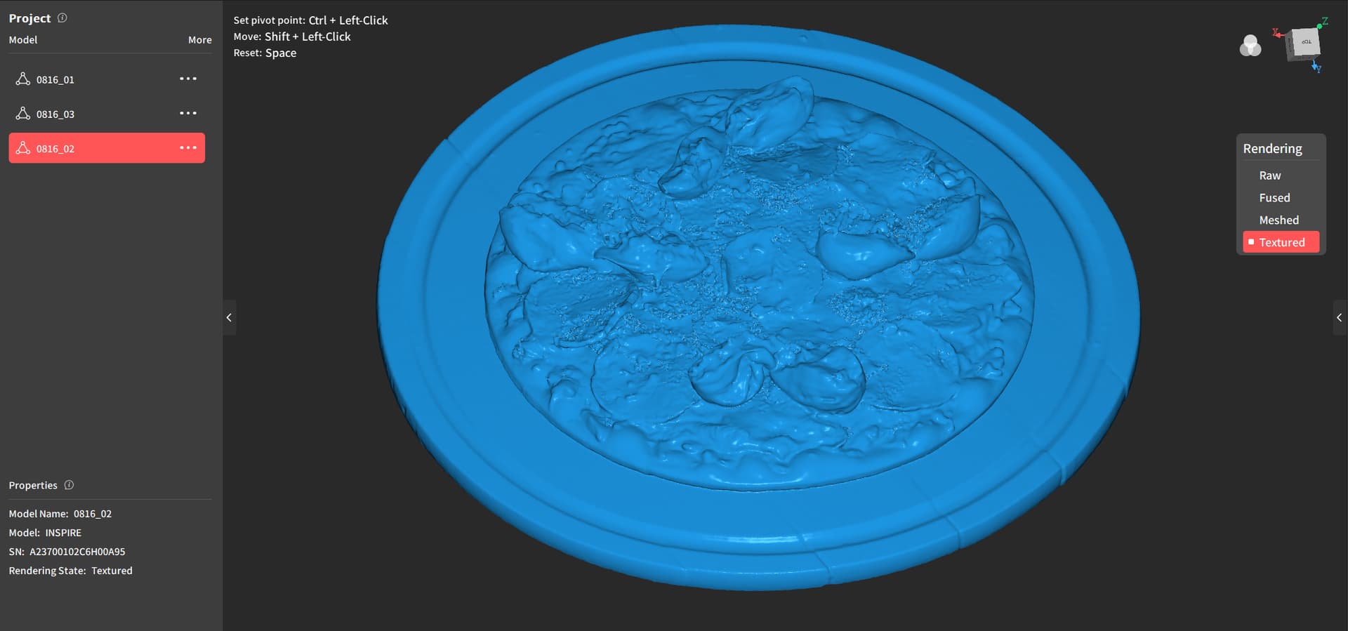

I recently scanned some food with the INSPIRE, first one is texture the other is simply pointcloud color.
Food usually is easy to scan, at worst you can use cornstarch and rubbing alcohol on a spray bottle to matt up some of the surfaces of the dishes
if the food is too smooth to pick up on the feature mode you can always use the crumpled paper method to add a rich feature detail to your scan model
