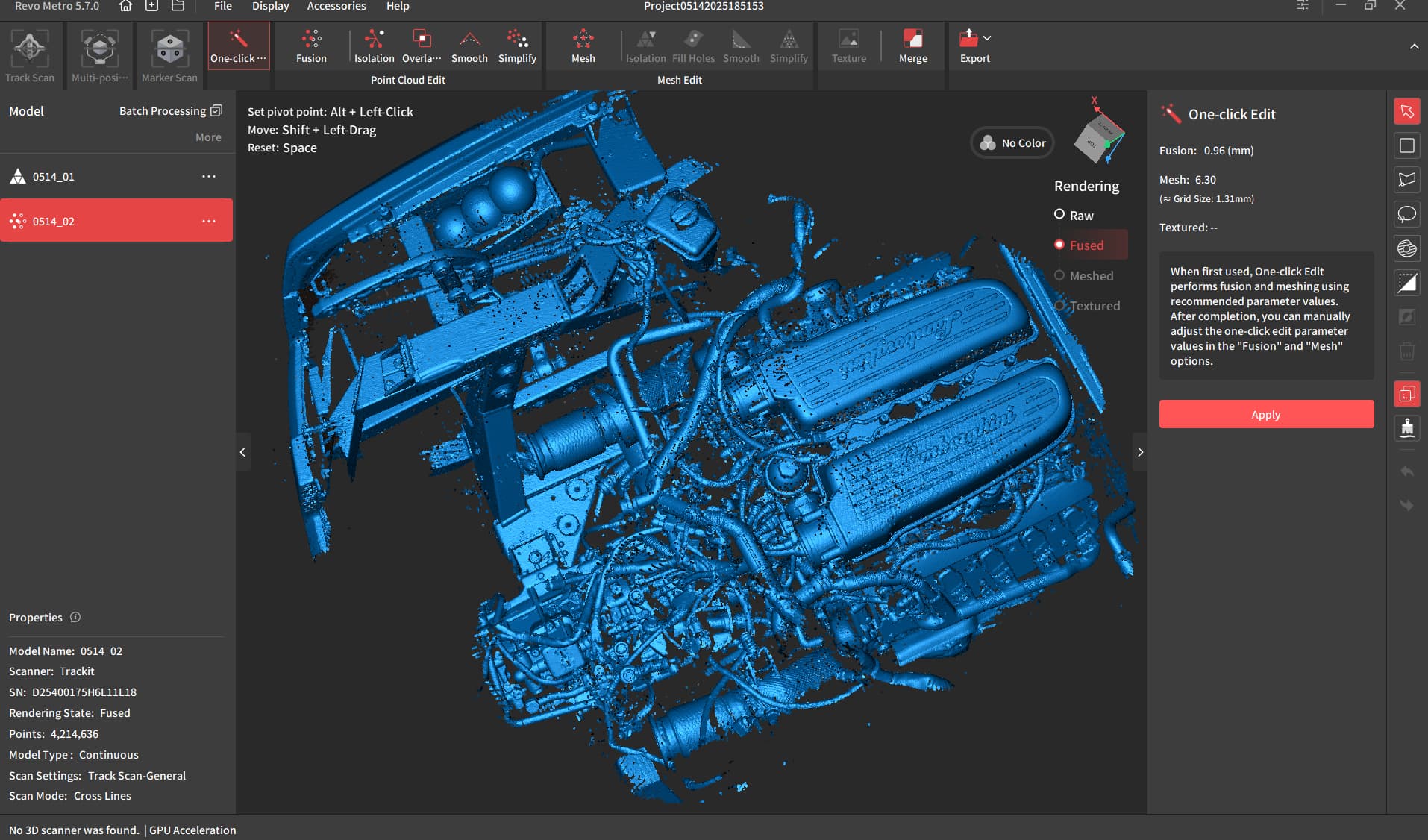

The plan with this car above is to replace the radiator and remove the supercharger and fit a big turbo and big intercooler, this scan and others will help decide size and locations of the new parts and required brackets and design the exhaust system for the turbo
Ken , it is powerful , and it have a mode that it can scan big objects one part by part at once without the needs of merging.
This mode allows you to move the Tracker while capturing it.
Of course it will depends on the RAM available on your computer how big you can go.
The mode require to create sections and put couple of magnetic markers between the sections only so merge can happen automatic while scanning .
You have to use some markers to do multi position mode
Minimum of 5 markers, so you can scan an object and turn it over mid scan and as long as the tracker can see the 5 markers you can continue on the other side without stopping, all one continues scan,
Or you can do section at a time and move the tracker on bigger objects
But if you already finished scanning and realised that you missed something you can just do another scan and use merge to align that missing section
