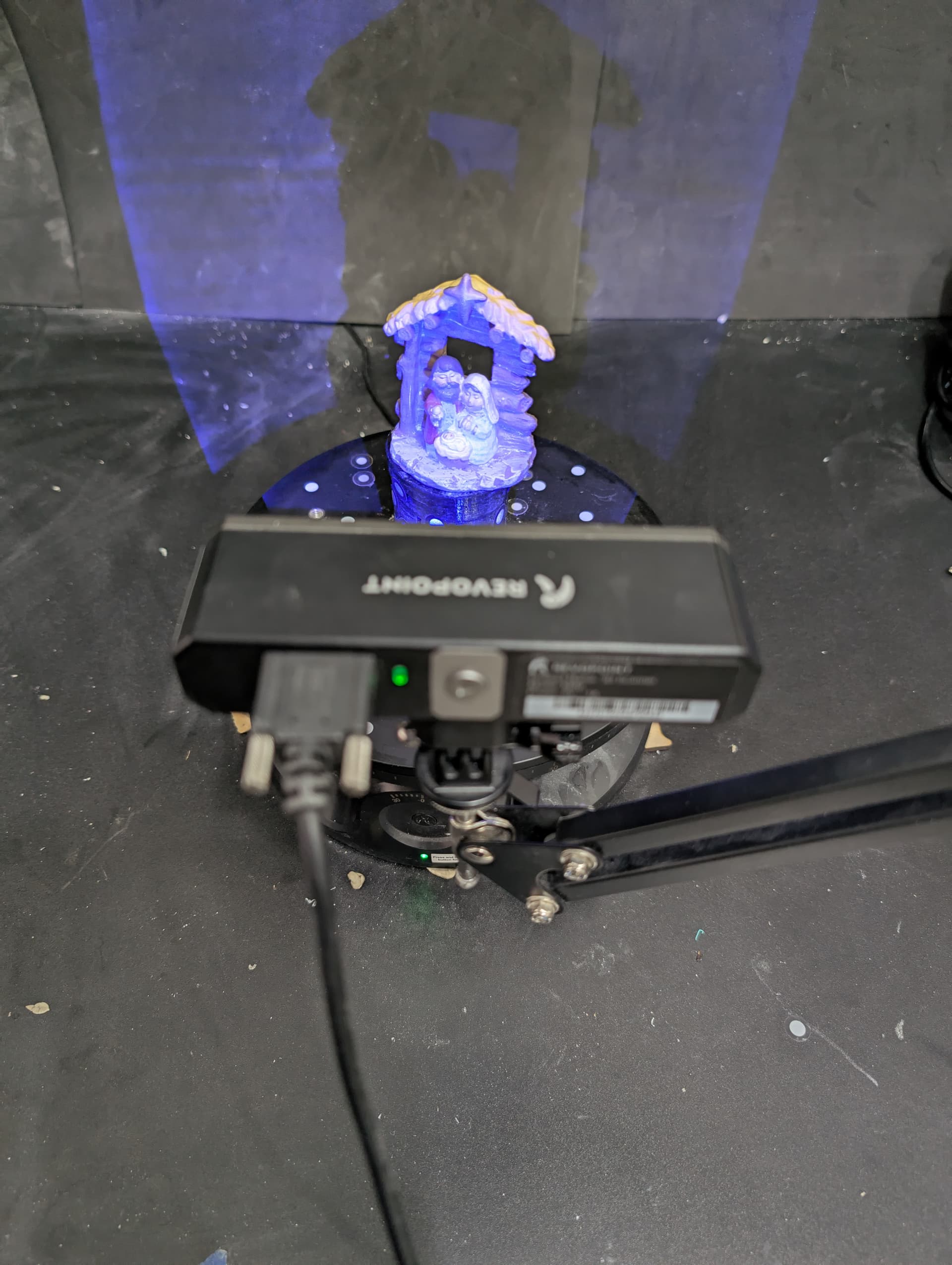

I scanned a small nativity scene, measuring 70x60x28mm. The scan was done with the subject placed on a turntable and the scanner mounted on an adjustable arm. The scan was completed in one session, with 4 repositioning of the scanner and 1 repositioning of the subject. The point cloud was fused in Advanced mode at 0.9mm, and after a quick cleanup in RevoScan5, the mesh was created at level 6 with a resolution of 0.9mm. The finished model was imported into PrusaSlicer for a quick orientation and cutting operation, since the original model doesn’t have perpendicular surfaces; this step was done to facilitate printing.
